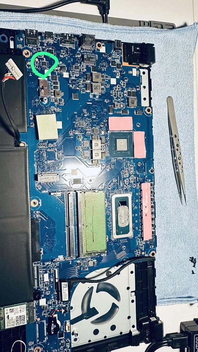

Model MS-15K11 REV 1.0
W25Q256FV-NOVIDEO.BIN
you need try more bios new and check hardwareHELLO, I PUT THE FILE, BUT THE LAPTOP DOESN'T TURN ON, PLEASE HELP ME
ec name? you can read old ??does the EC need to be programmed? thanks in advance
current not see info Programming ec thisThe chip is ITE5571VG-128, its burned... in ali there is a seller with the programmed chip. so.. there is.. code and pinout... thanks in advance..
I was able to program it... i use KB_pins=40 05MM RIGHT DOWN PD0=40 PD1=39 PD2=38 PD3=37 PD4=36 PD5=35 PD6=34 PD7=33 BUSY=31 STB=17 AFD=18 INIT=19 SLIN=20 KSI4=21 KSI5=22 CHIP=IT5571VG-128 (Igor) and the mother works ok finally.. thankscurrent not see info Programming ec this

@ThienBui cái này em k hiểu, xin mã chân chép io cho máy SVOD 3 với huynh.I was able to program it... i use KB_pins=40 05MM RIGHT DOWN PD0=40 PD1=39 PD2=38 PD3=37 PD4=36 PD5=35 PD6=34 PD7=33 BUSY=31 STB=17 AFD=18 INIT=19 SLIN=20 KSI4=21 KSI5=22 CHIP=IT5571VG-128 (Igor) and the mother works ok finally.. thanks
Its the pinout.. i have vertyanov.. so in the config (file txt) put that pinout and worked.. i dont have vertyanov so you need to create your pin out taking tha info@ThienBui cái này em k hiểu, xin mã chân chép io cho máy SVOD 3 với huynh.
