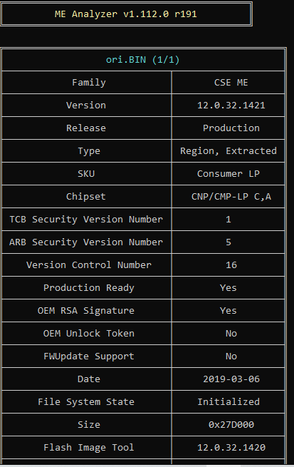

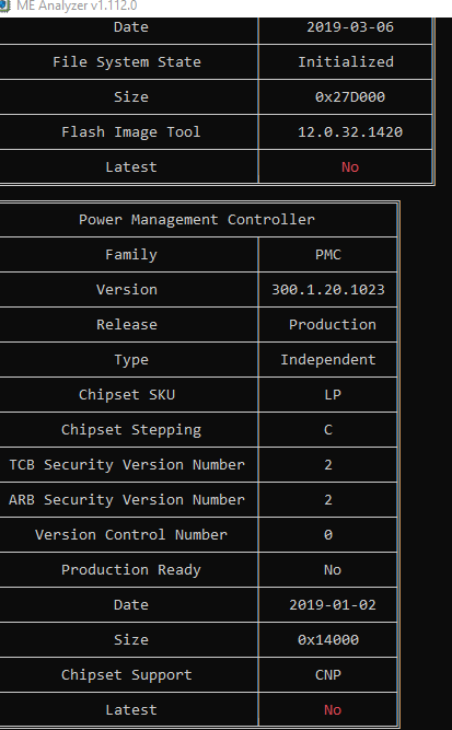

laptop dell mainboard BOLT 1SP DIS 4GB 18790-1 XV3Y6$la, it gives me the following error. 3 amber and 5 white flashes. they only turn on the fans, I programmed the bios with the one in the vinafix profile and I get the same error.
bios MXIC MK 25L12872F
please. Thanks, I attached photos.

This image doesn't make any sense, you need to try another BIOS to compare.
