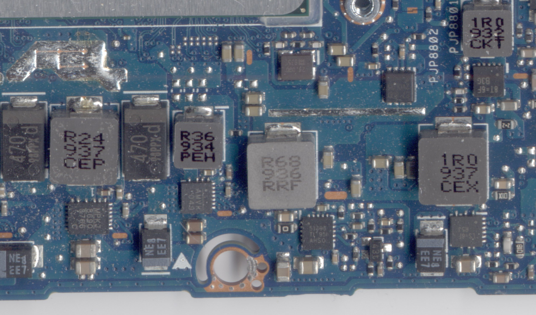

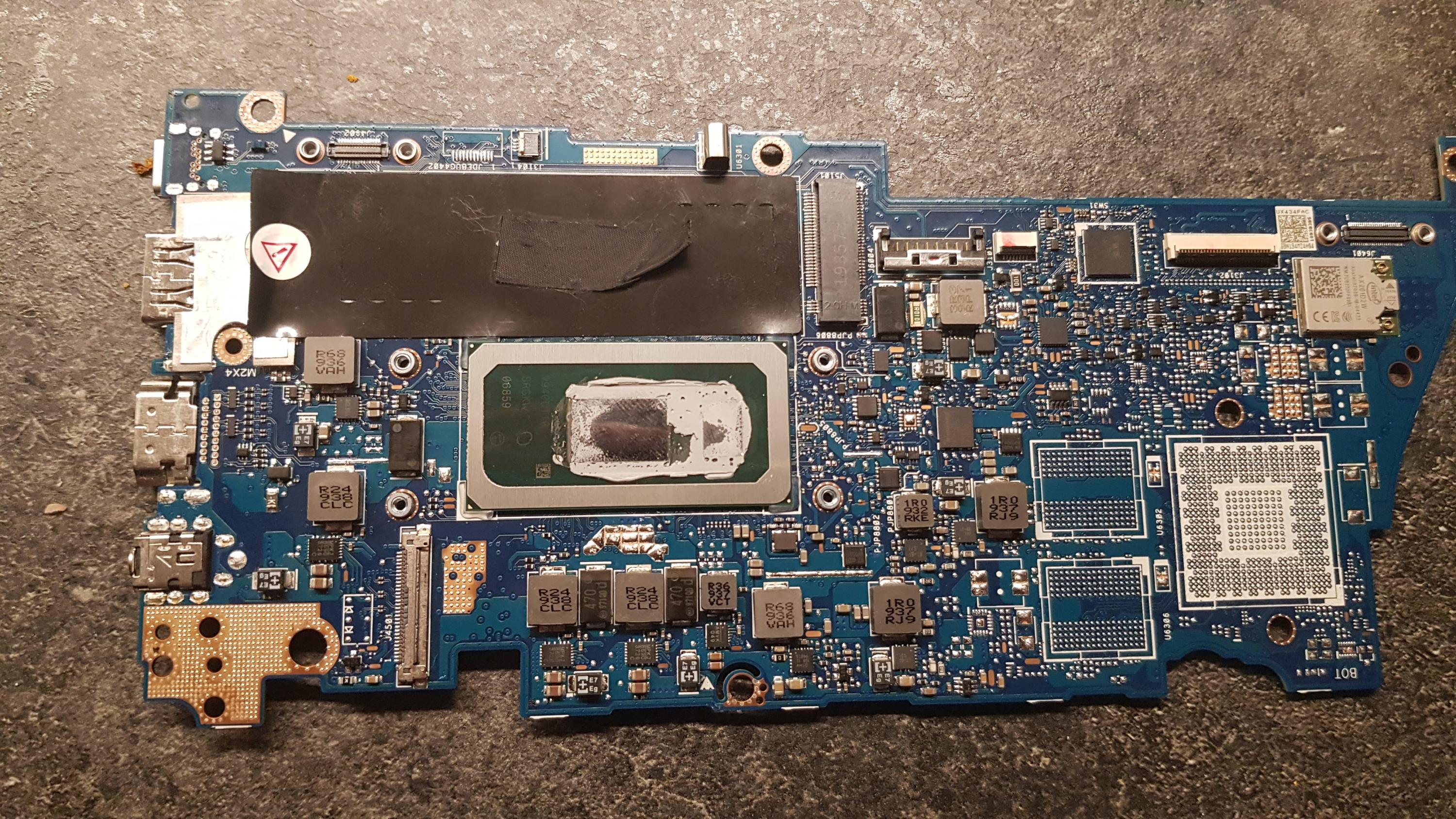

ZenBook UX334FL MOBO​
IT ALREADY LIQUID DAMAGED AND PRE-REPAIRED

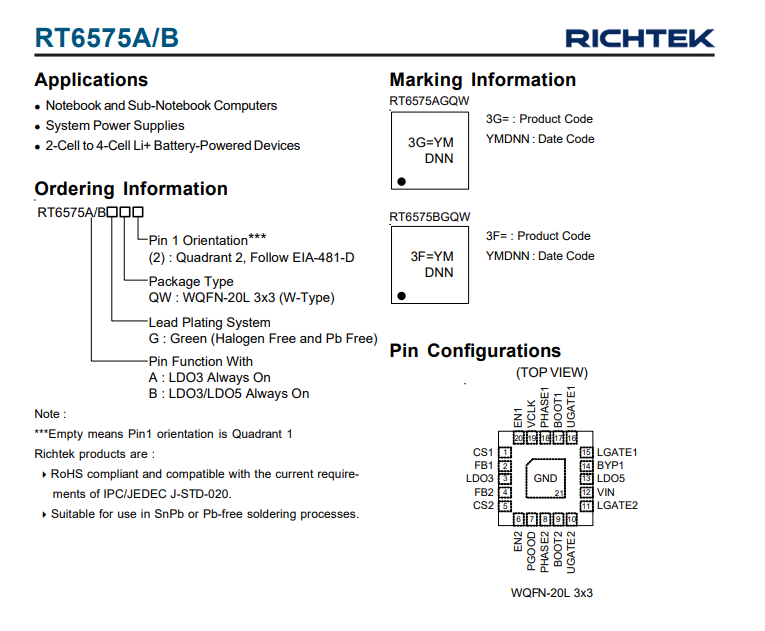

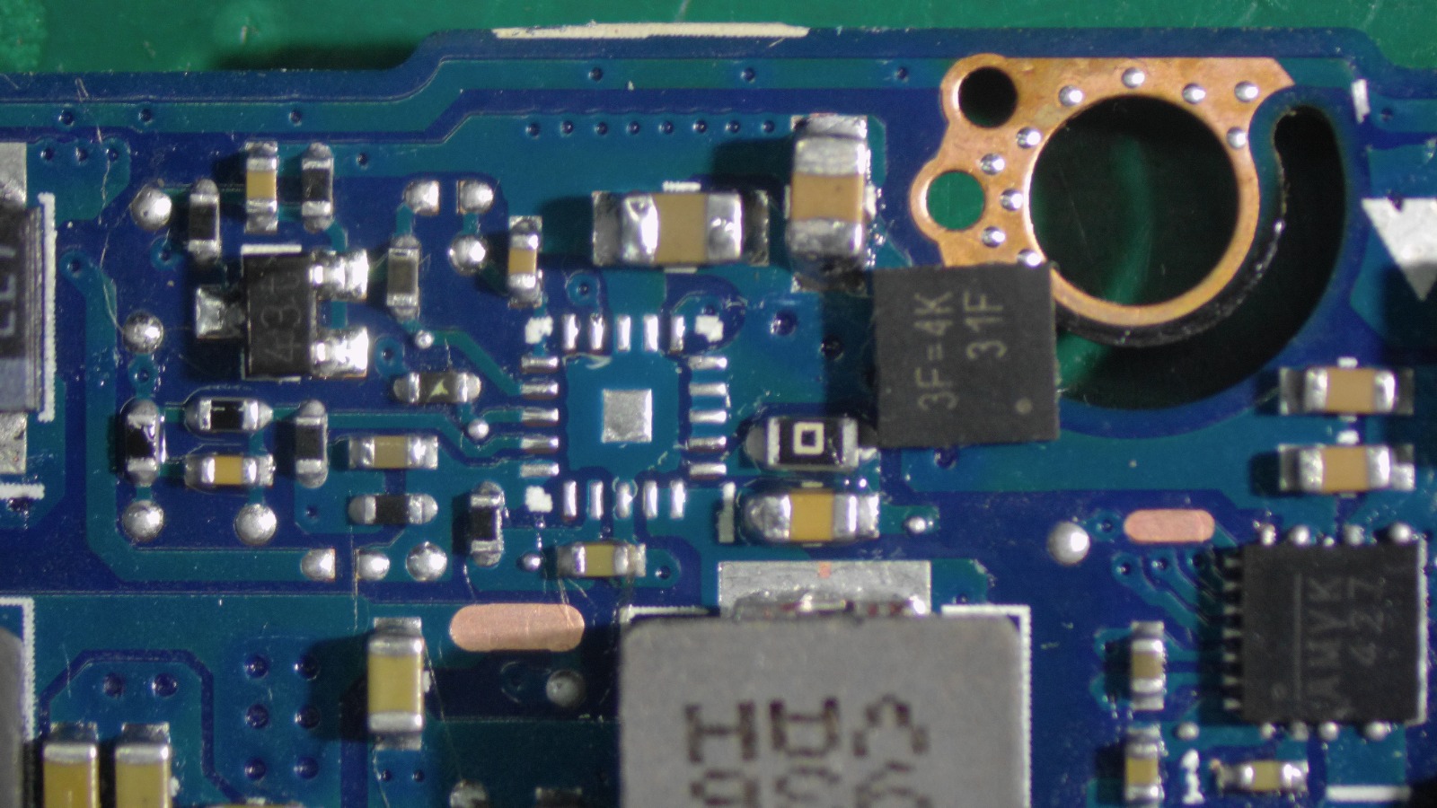

I FOUND SHORT CIRCUIT IN BOARD DUE WRONG 3F= MARKED IC DC-DC CONTROLLER REPLACED MISTAKENLY AND IT " Dual-Channel Synchronous DC-DC Step-Down Controller with 5V/3.3V LDOs".

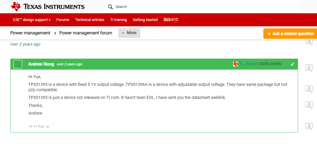

I SUPPOSED THE TRUE DC-DC IC IS TPS51395 SHOWN IN THE PHOTOS IN THE FIRST OF THIS THREAD , AND MORE THAN 10 COMPONENTS ARE REMOVED FROM BOARD :confused:
UNFORTUNATELY TPS51395 PDF NOT AVAILABLE , BUT IN " Texas Instruments" WEBSITE SOMEONE NOTICESD THAT IC IS 5.1V OUTPUT !? AND I SUPPOSE IT'S WRONG .

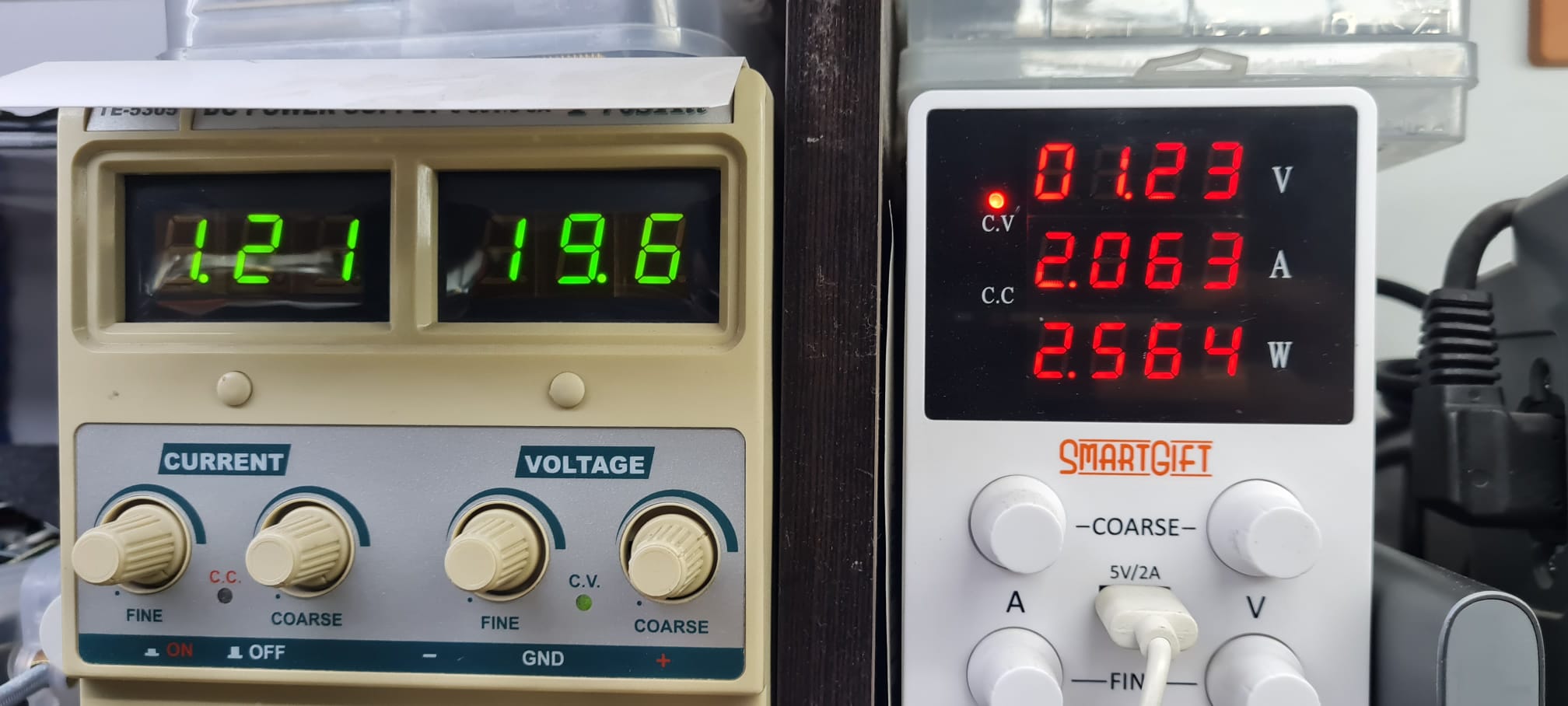

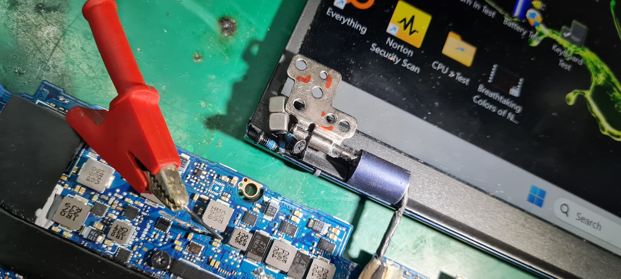

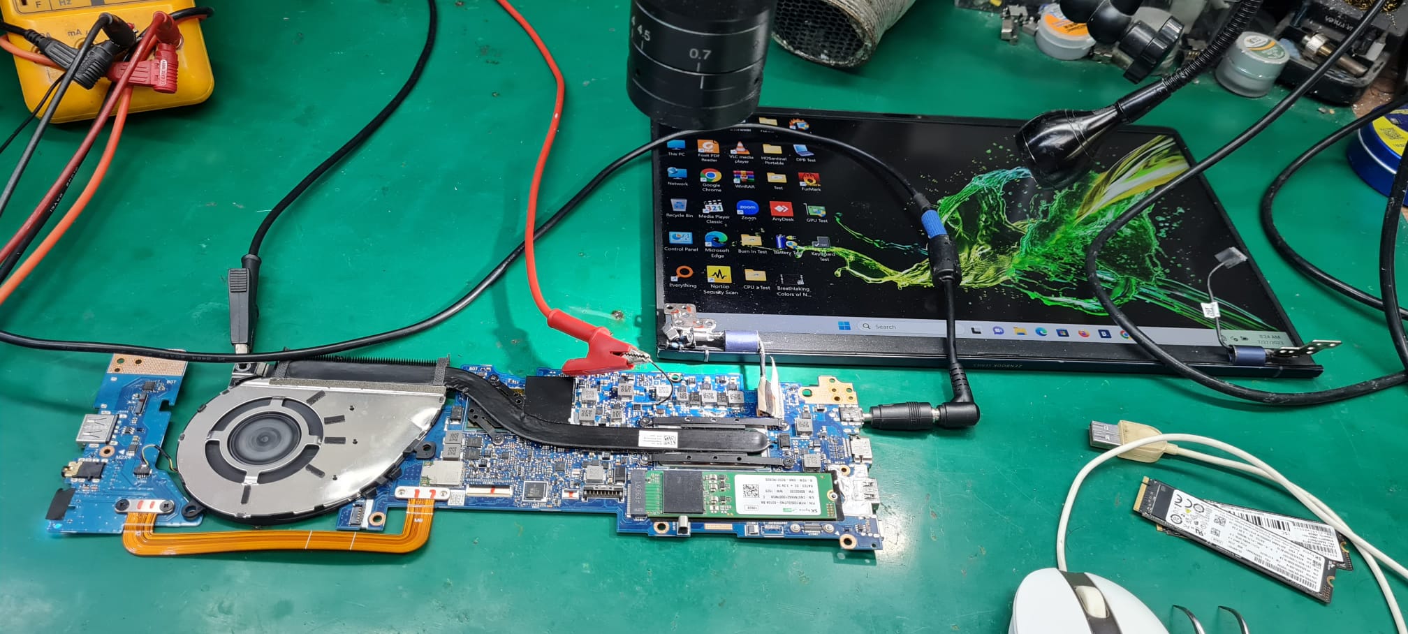

I SUPPOSED THIS STEP DOWN REGULATOR OUTPUT IS 1.2 V AND WHEN I PROVIDE EXTERNAL 1.2V THE BOARD WORKS PERFECTLY .
SUGGESTIONS WITH NO SCHEMATIC AND BOARDVIEW AVAILABLE ?

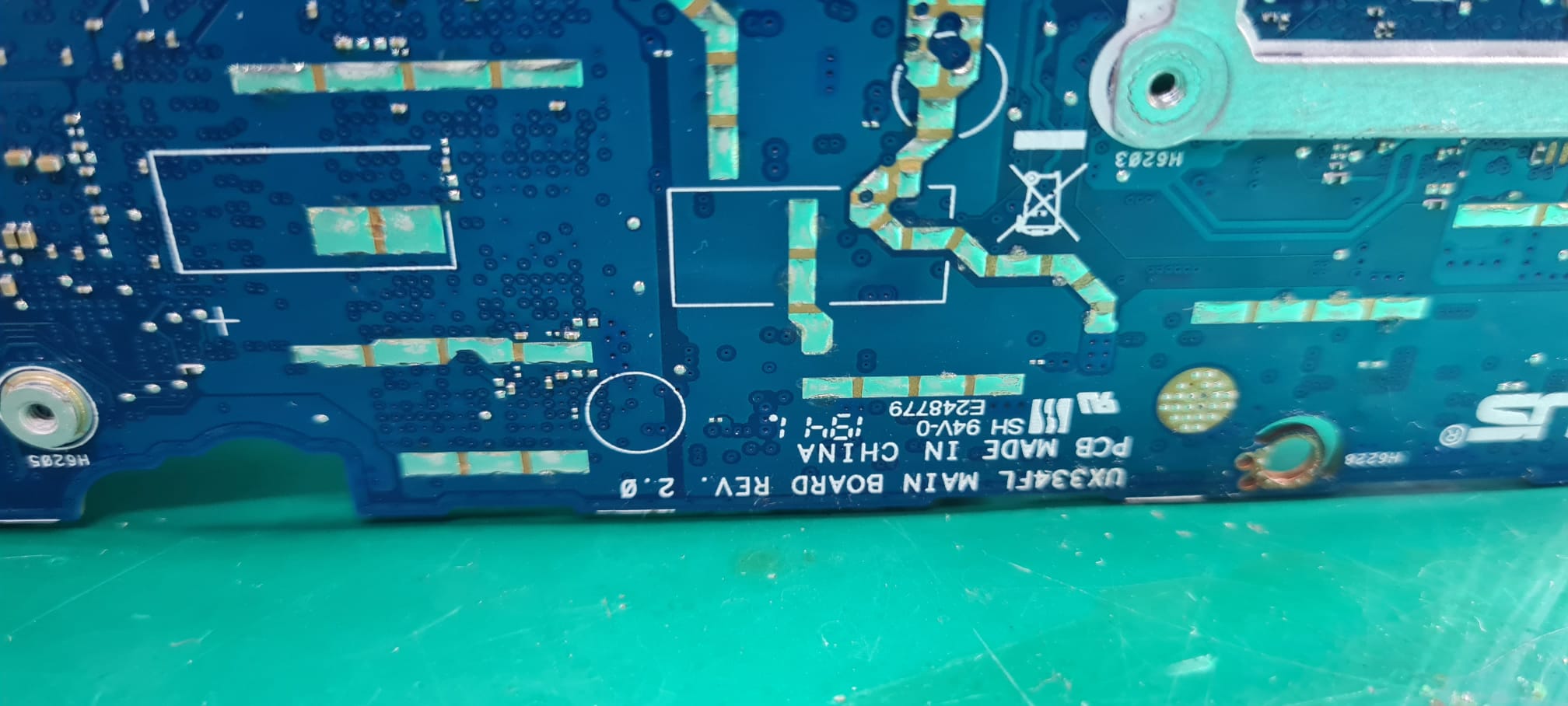

Laptop : UX433FAC
Motherboard model : UX334FL rev 2.0
