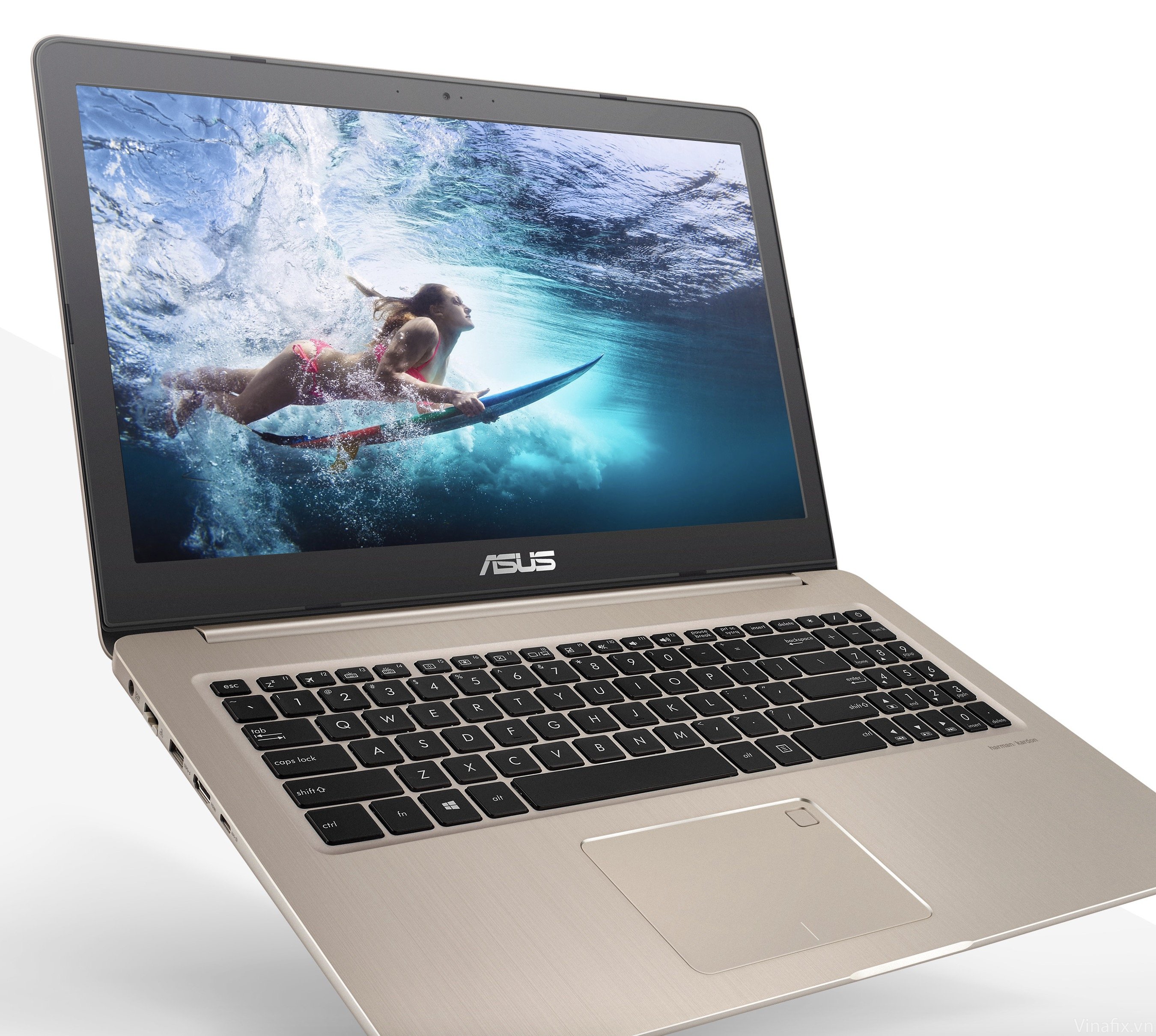

Hello,
i got same model as shown in the picture: N580VN
The problem is no video. I tried the bios above but same problem start but no video. Unfortunately i don' t have the original dump, i'm sure this is a bios problem, can you kindly help me?
send old bios i help buildss
Thank you, i tried to flash this bios but same problem. It start but no video fan spins at fixed speed and keyboard backlight always on.
Hello,
Only Intel Graphics is visible in device manager, same in linux. I programmed clearme (nothing changed) from this topic and one additional named build.bin (turning on with blank screen), In addition LAN not working. Can you chceck this BIOS?
X580VD_ORIGINAL.bin
Hello again,
It turns that after programming buildsssss NVIDIA works correctly but WiFi is not working, on original WiFi is ok.
