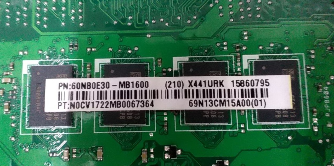

bigphong Active Member BUSINESS VIP Aug 17, 2020 #2 Plese Bios .. X441UR Part X441UV MAIN BOARD REV 2.1 CPU i3-6006U VGA 930 MX Old file Can't see driver VGA. Download list Backup.rar 3.2 MB · Views: 19
ThienBui Techniques Supporter Aug 17, 2020 #3 bigphong said: Plese Bios .. X441UR Part X441UV MAIN BOARD REV 2.1 CPU i3-6006U VGA 930 MX Old file Can't see driver VGA. Click to expand... provided model above sticker on slot ram
bigphong Active Member BUSINESS VIP Aug 17, 2020 #4 ThienBui said: provided model above sticker on slot ram Click to expand... Download list
ThienBui Techniques Supporter Aug 17, 2020 #5 i check bios you send not for model X441UR Please check right BIOS
bigphong Active Member BUSINESS VIP Aug 17, 2020 #6 ThienBui said: i check bios you send not for model X441UR Please check right BIOS Click to expand... Yes sir.. It has been repaired before. Orther shop
ThienBui Techniques Supporter Aug 17, 2020 #7 bigphong said: Yes sir.. It has been repaired before. Orther shop Click to expand... try it Download list X441URK.315.zip 5.6 MB · Views: 27
