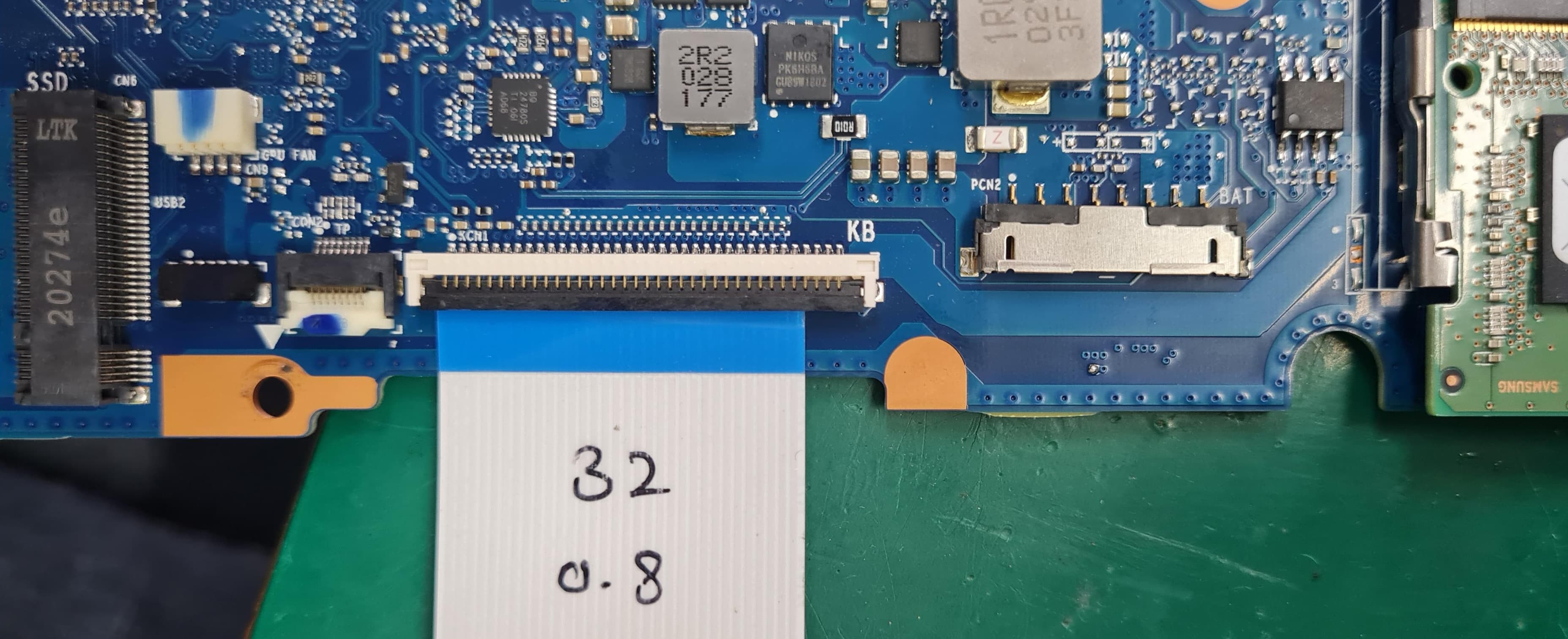

ITE8987VG KB 36 BUT USE 32 PIN FROME 1 TO 32
Quanta BKX KB_pins=32 0.8MM PD0=29 PD1=20 PD2=15 PD3=23 PD4=14 PD5=16 PD6=12 PD7=30 BUSY=26 STB=18 AFD=28 INIT=21 SLIN=19 KSI4=22 KSI5=24
TESTED OK
