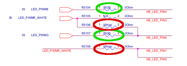

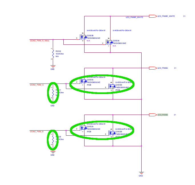

Initially, the laptop came with a non-RGB keyboard, but it was replaced with an RGB model. Some missing components on the board, such as Q3505, Q3502 (PMDXB600UNE), R3511, R3509 (100kΩ resistors), R3564, R3574, R3104, R3107 (0Ω resistors) were added. Resistors R3106 and R3108 were also removed from the board.
After these changes, the keyboard still only lights up in one color, red.
Does anyone know if there are other modifications that need to be made to the board? Is this included in the BIOS or in the IT8259E-248A firmware?

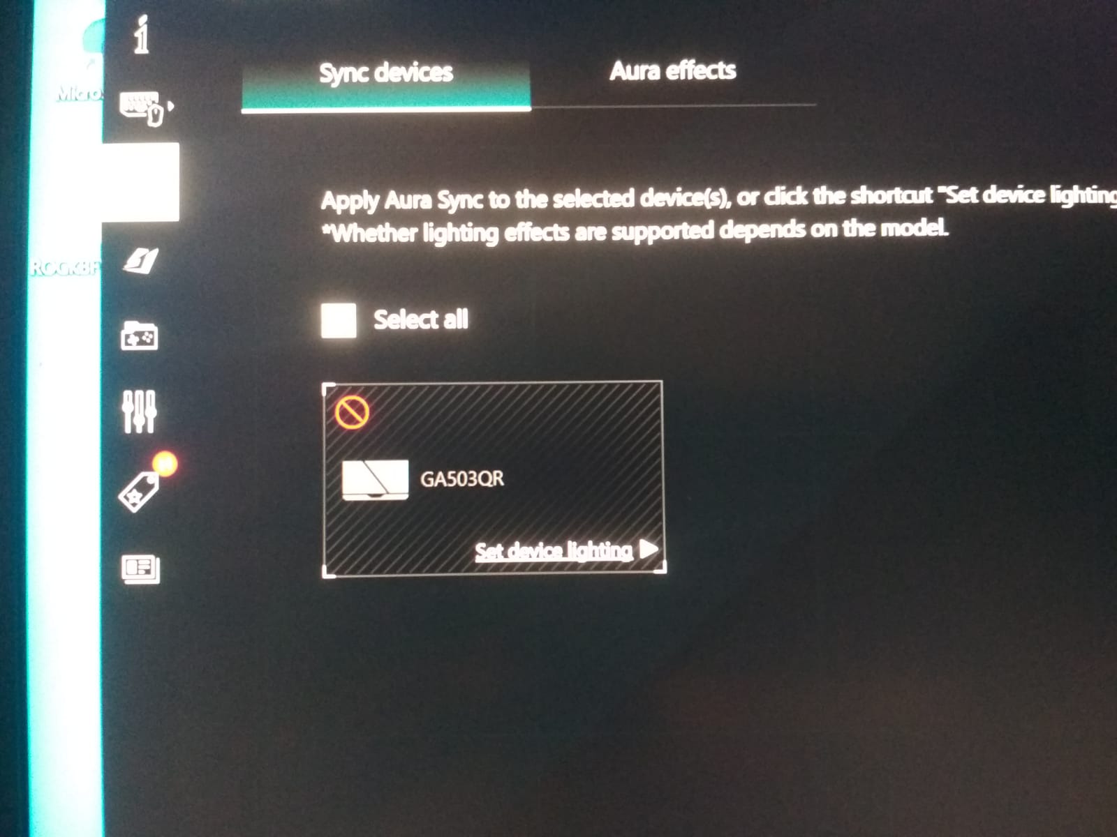

AURA SYNC does not detect the RGB keyboard.

Thank you, but your file is identical to what I did with the update file.
Nonetheless, I decided to check it and the result is the same as in the picture.

Regardless of the BIOS stock on pin 2 and 5 of the Q3503 there is a nice square wave signal. There is no signal on pins 2 and 5 of Q3502 and Q3505.
The only thing I managed to do was change the color of the backlight from white to red.
Perhaps the ITE software is responsible for the RGB lighting. Thank you for trying to help.
