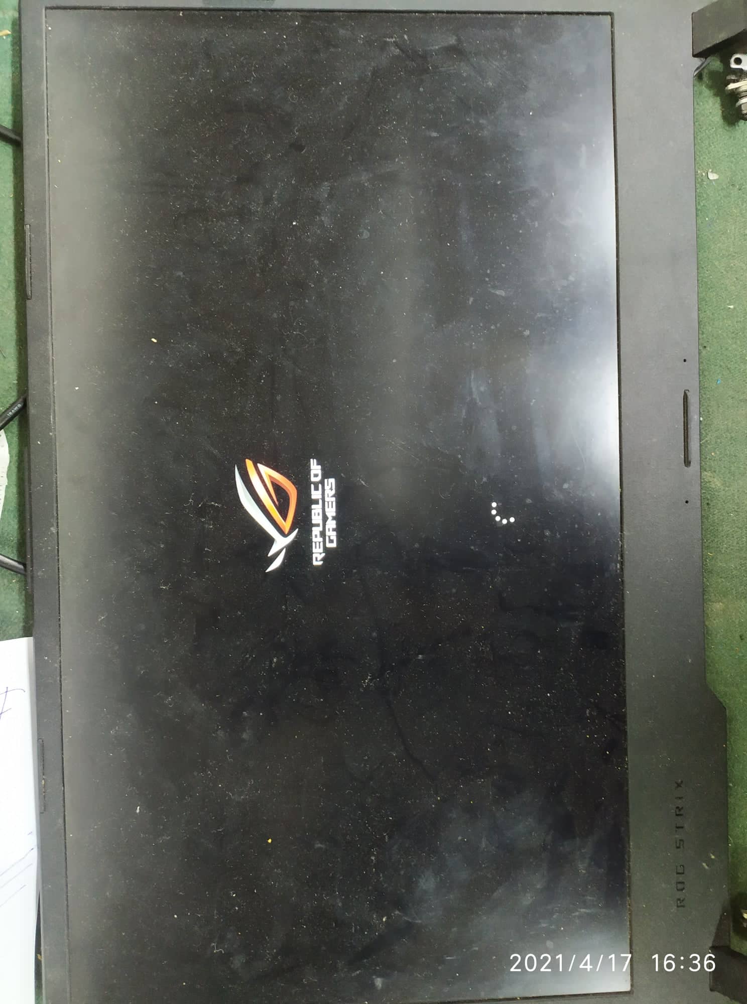

Hello, my original problem is stuck on LOGO While trying booting to windows.
after using that file (No Storage Device Present).
my original file attached
thank you
Backup.BIN
the M.2 SSD now shown.
but the same old problem still exist.
stuck on logo screen when booting to windows.
i attached a pic for the problem.
i changed the M.2 SSD. same problem presence.
RAM changed, same problem.
next yoy need check all hardware
