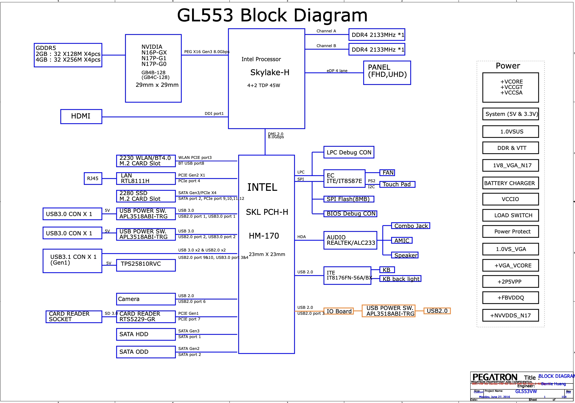

original file to flash the smal IT near keyboard conector . an error made by many , thinking that they are flashing the SIO and in the end keyboard stop being inresponsive !
so for does more distracted , keyboard conector is not for SIO programming , its only for KEYBOARD programing and backlight keyboard .
J3001 near SIO is the correct socket to flash the SIO
