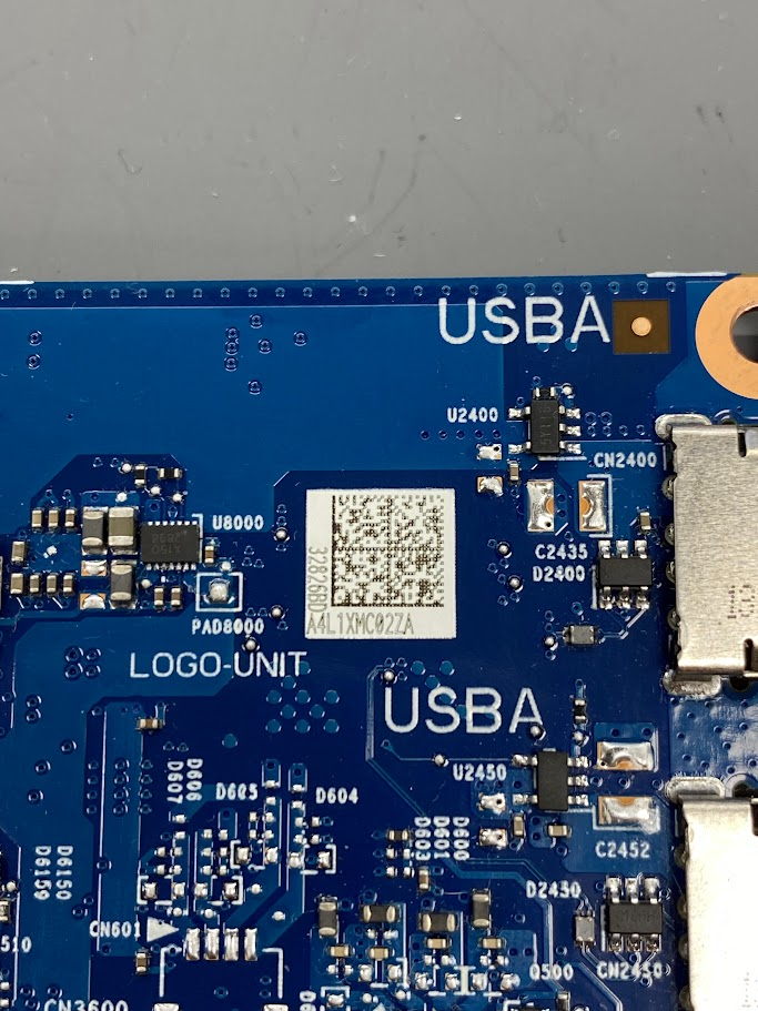

ASUS TUF G513
Motherboard:
G513-6050A3249301-MB-A04
S/N: MANRKD01498442C
Fault: The laptop powers on but does not display an image. The screen appears not to turn on, although on some occasions it does light up.
I will attach the original BIOS backup here for analysis.
Any help would be greatly appreciated.
