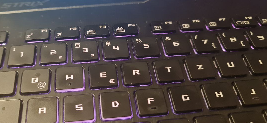

Hi , i originally owned a GL753VD - the mainboard was damaged -
so i became from a friend the mainboard from his old mainboard a GL753-VE - i now have the problem that the keyboard backlite is not working - is there a chance to fix this ?The Original Laptop came with an RGB Backlite Keyboard
Not all Keys are lightning an the Colour is fixed - when the laptop is turned off the keyboard will remain in lightning function
It's very difficult and impossible to fix from the bios
also a old flash will not help me with this?
What would be your recommendation? Unfortunately I can't get a new keyboard with a German layout
What would the solution be?
But thank you very much for your answer
If you want everything to work perfectly you need to replace the correct Motherboard
Thanks again for your expertise , is the chip not on the mainboard ?
i thought the ite chip is on mainboard - this is sad when there is no possibility .on the rog forums there some old threads that this is handled by an ec-firmware - so i thought there is a possibility
i still have the old mainboard but i get no output with this board so i think its damaged - the keyboard lights up but no graphic output - the board reboot itself - so i was happy to get the replacement with the stronger gpu on the gl753ve board
