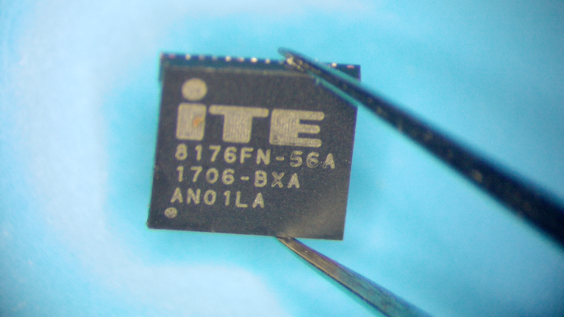

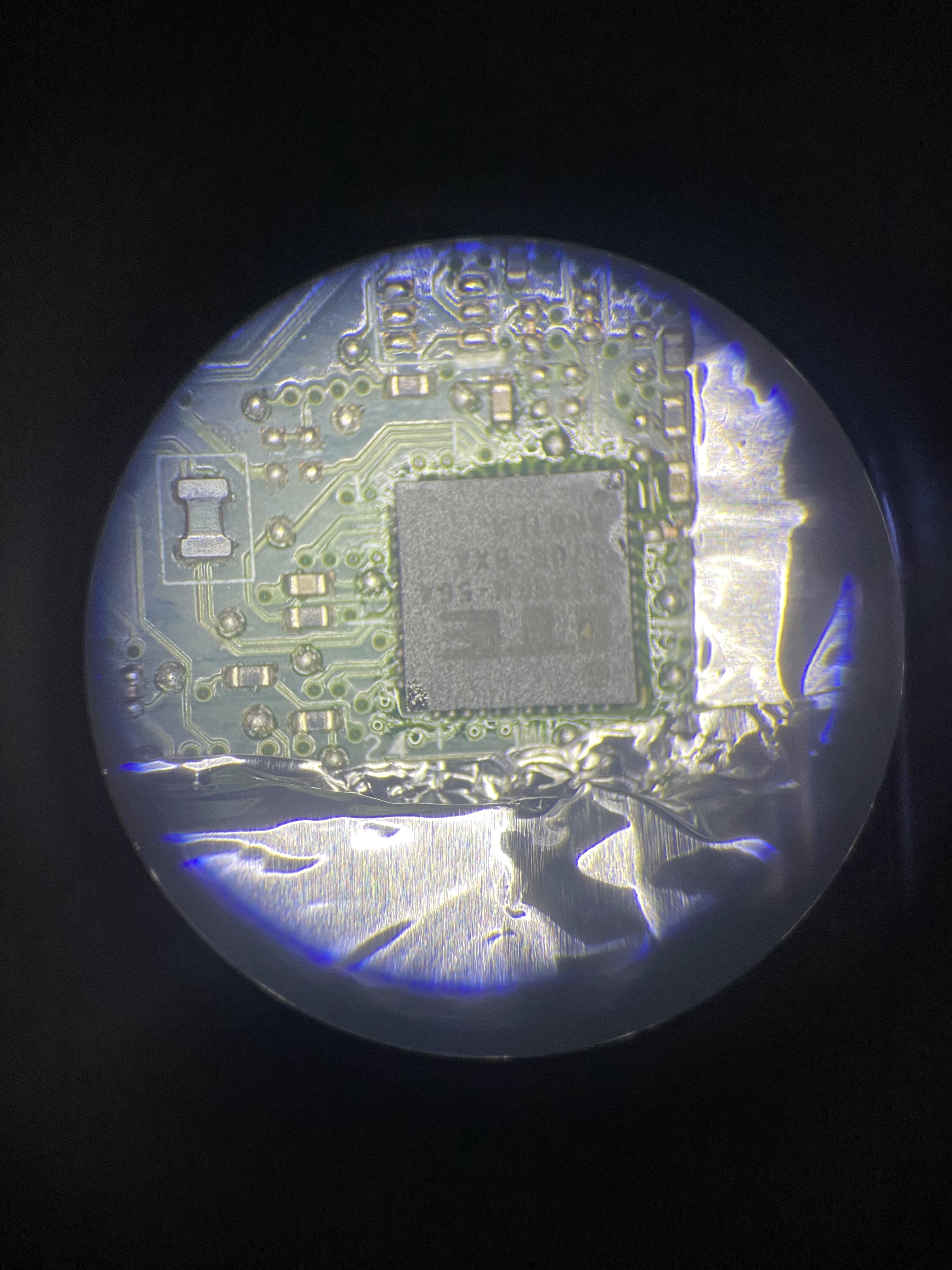

I can‘t reach bios with internal keyboard, so it‘s not driver issues. No shorts or blown resistors around the ITE controllers. Can I replace this one or does it need programming?
Chip is called ITE8176FN-56A

hello admin this laptop have 2 ite chip both are programable the ec is 128kb and ite it8176fn are also programable that responsible on keyboard and keyboard backlight functions. please check the photo below
Hi replace the IT8176FN, I had the same issue. But Keyboard backlight isn't working..
