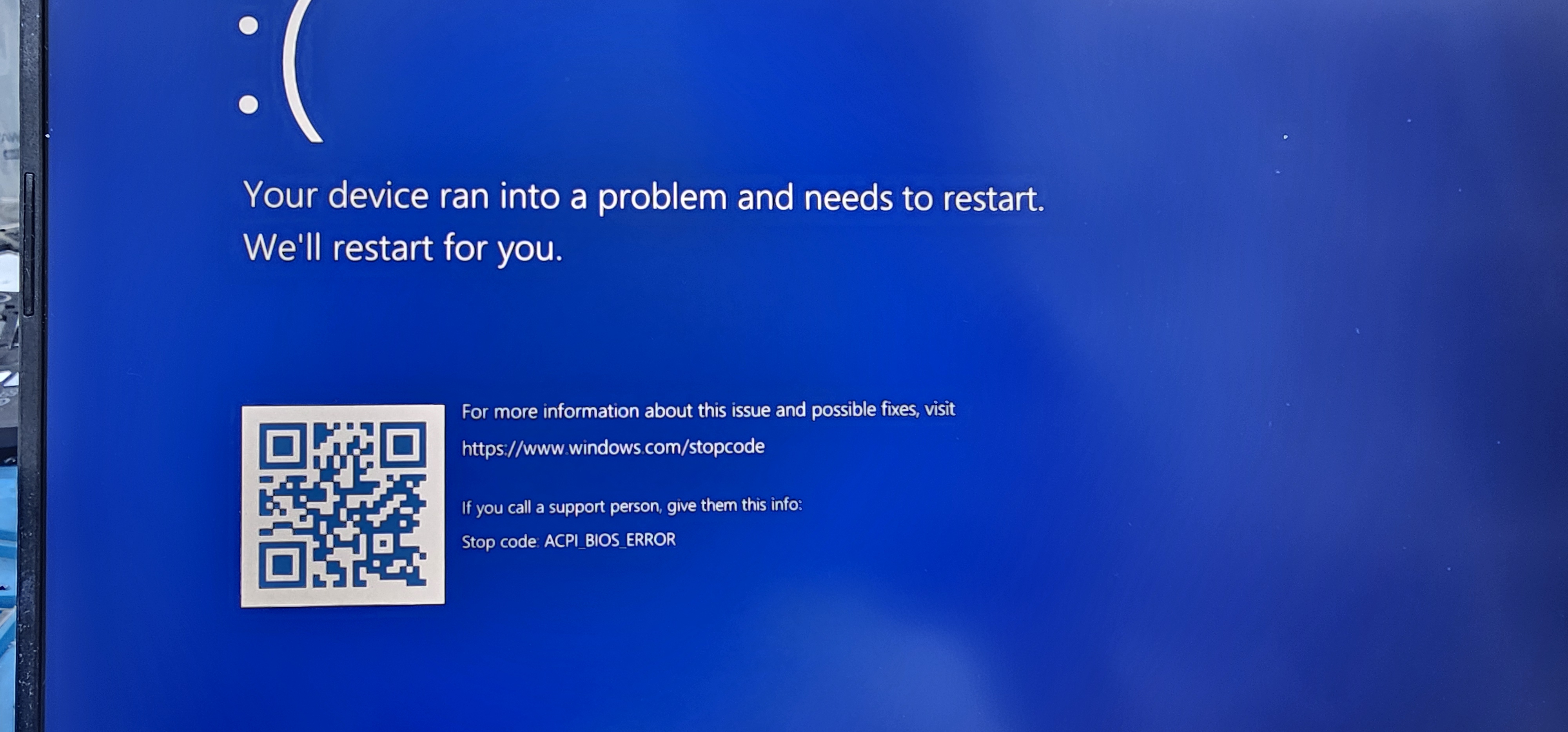

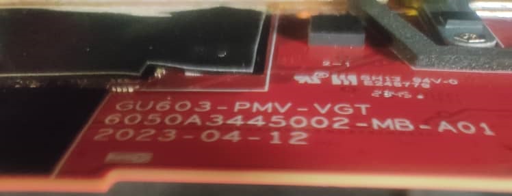

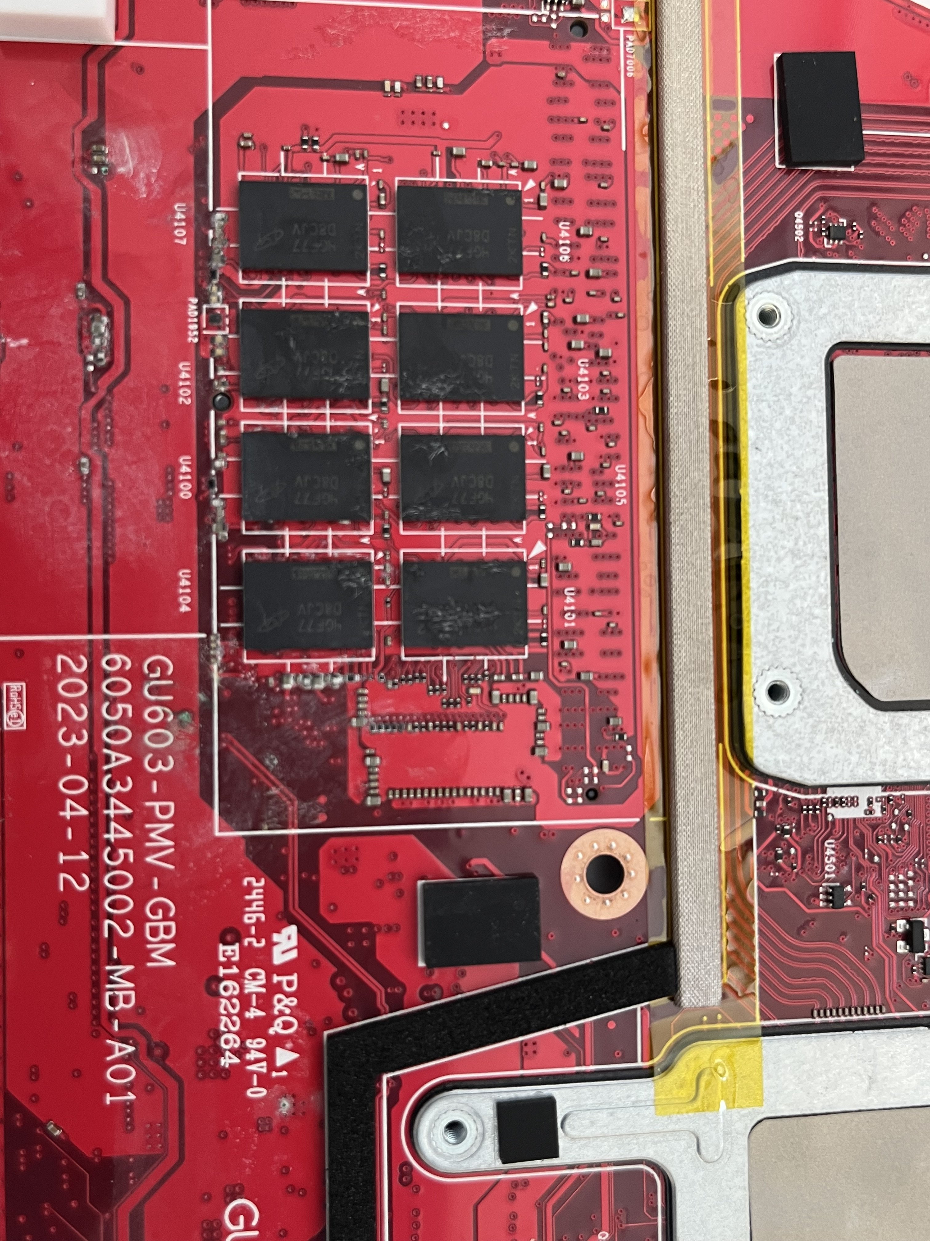

yes disable the ram. that area got corroded. checked AMP machine, looks like board boot stuck in memory process.
if we can disable the onboard ram, very good chance can fix it(will use the other slot to plug ram in)
model not support disable from bios
