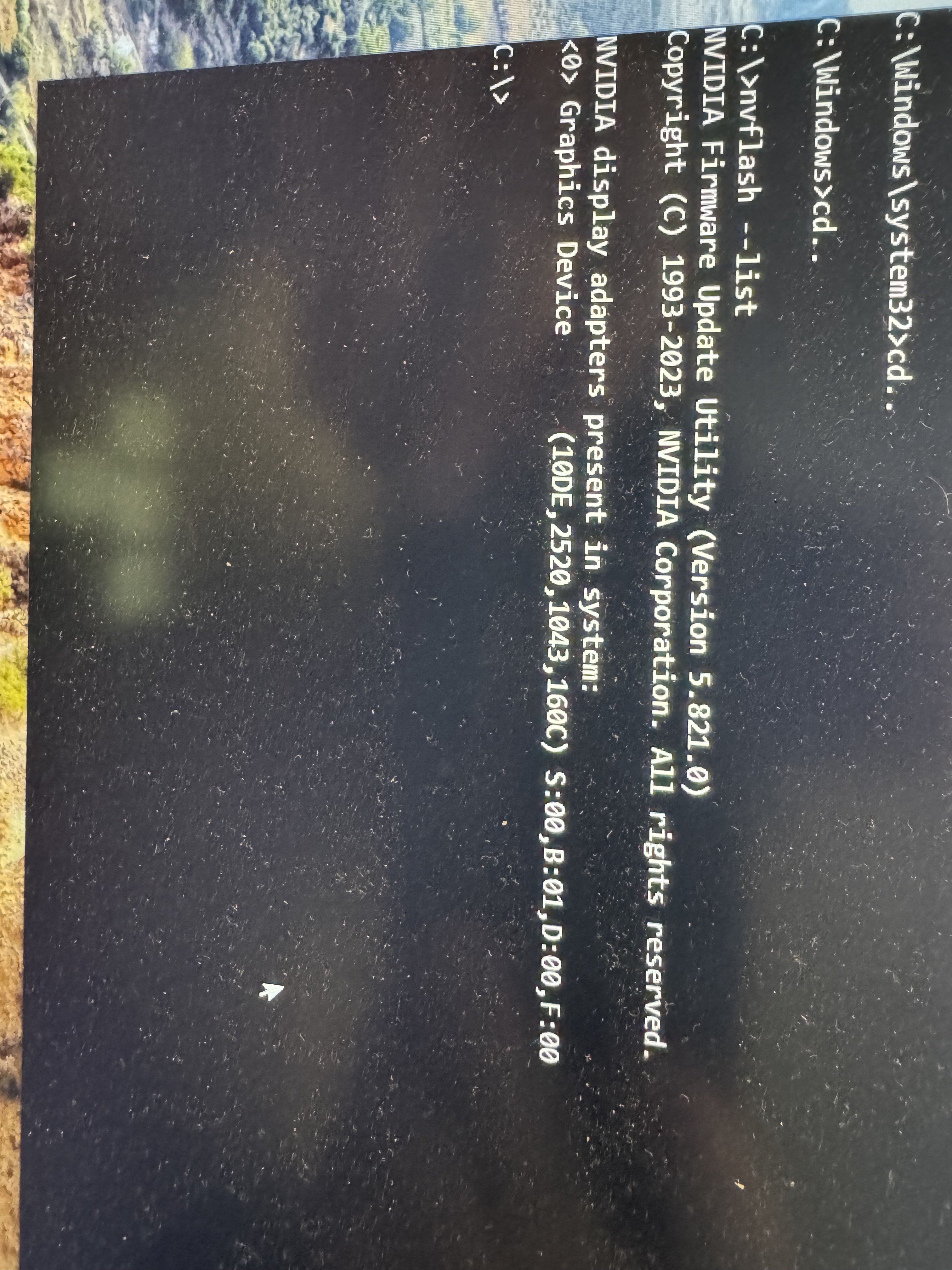

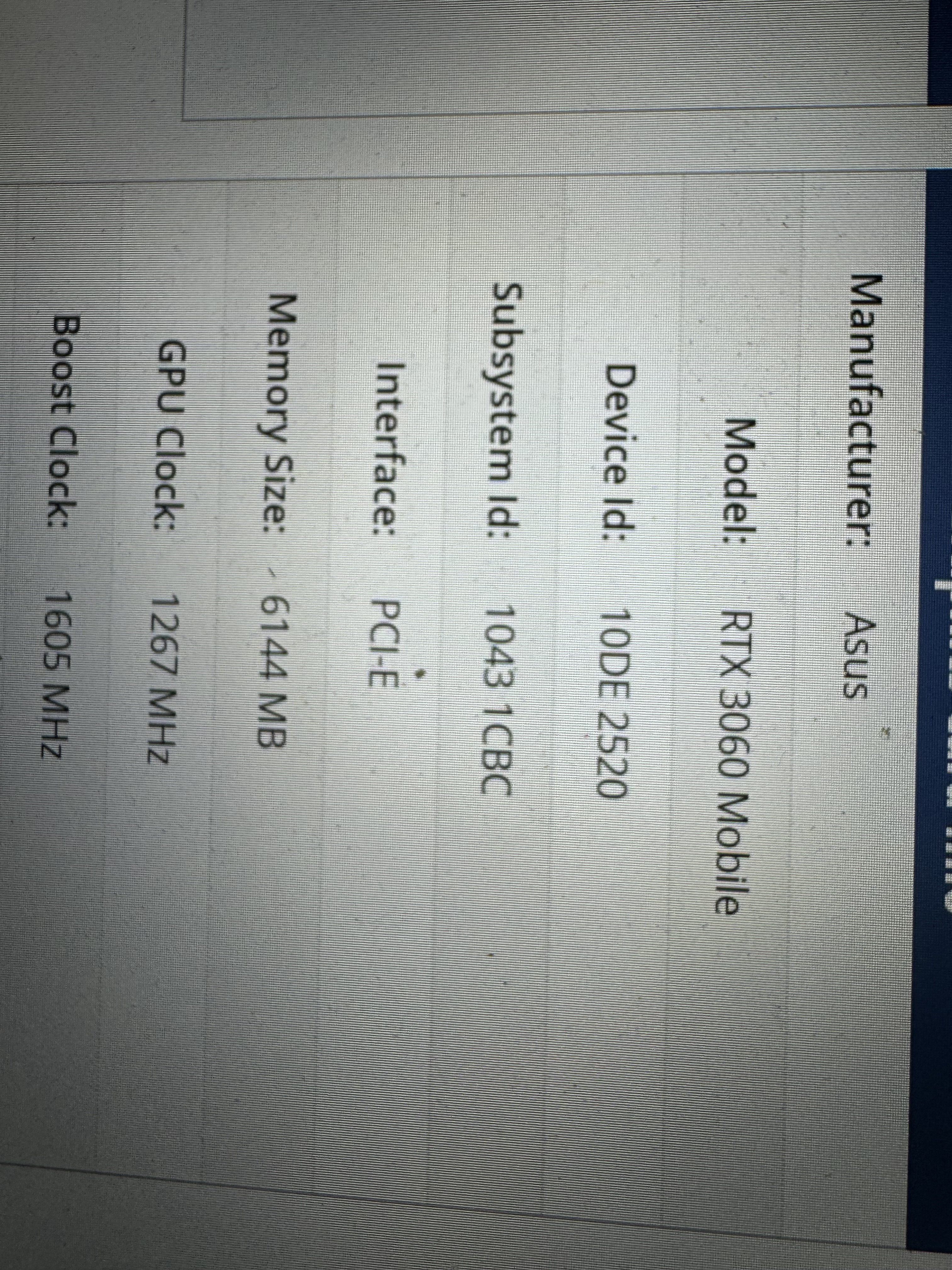

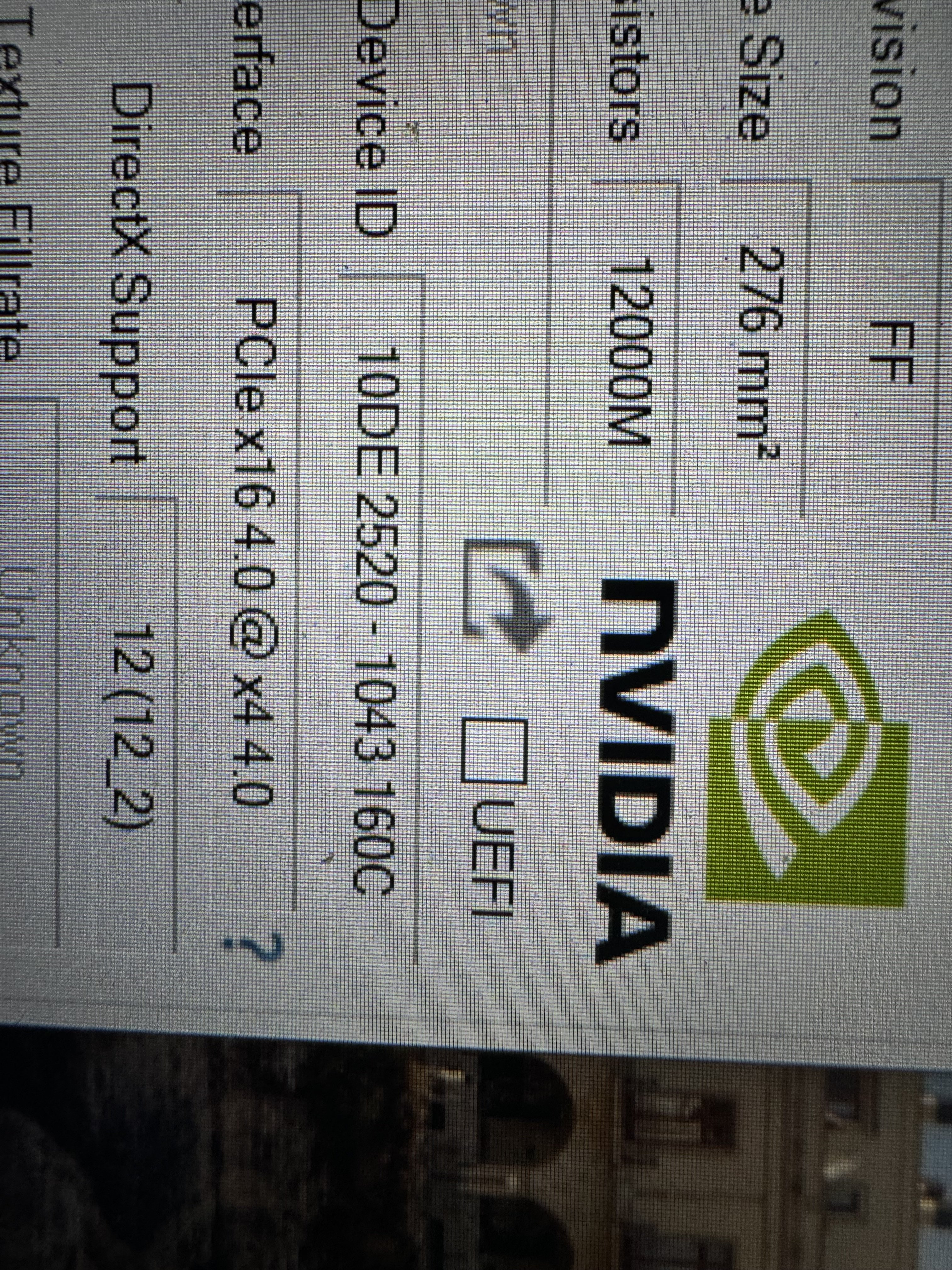

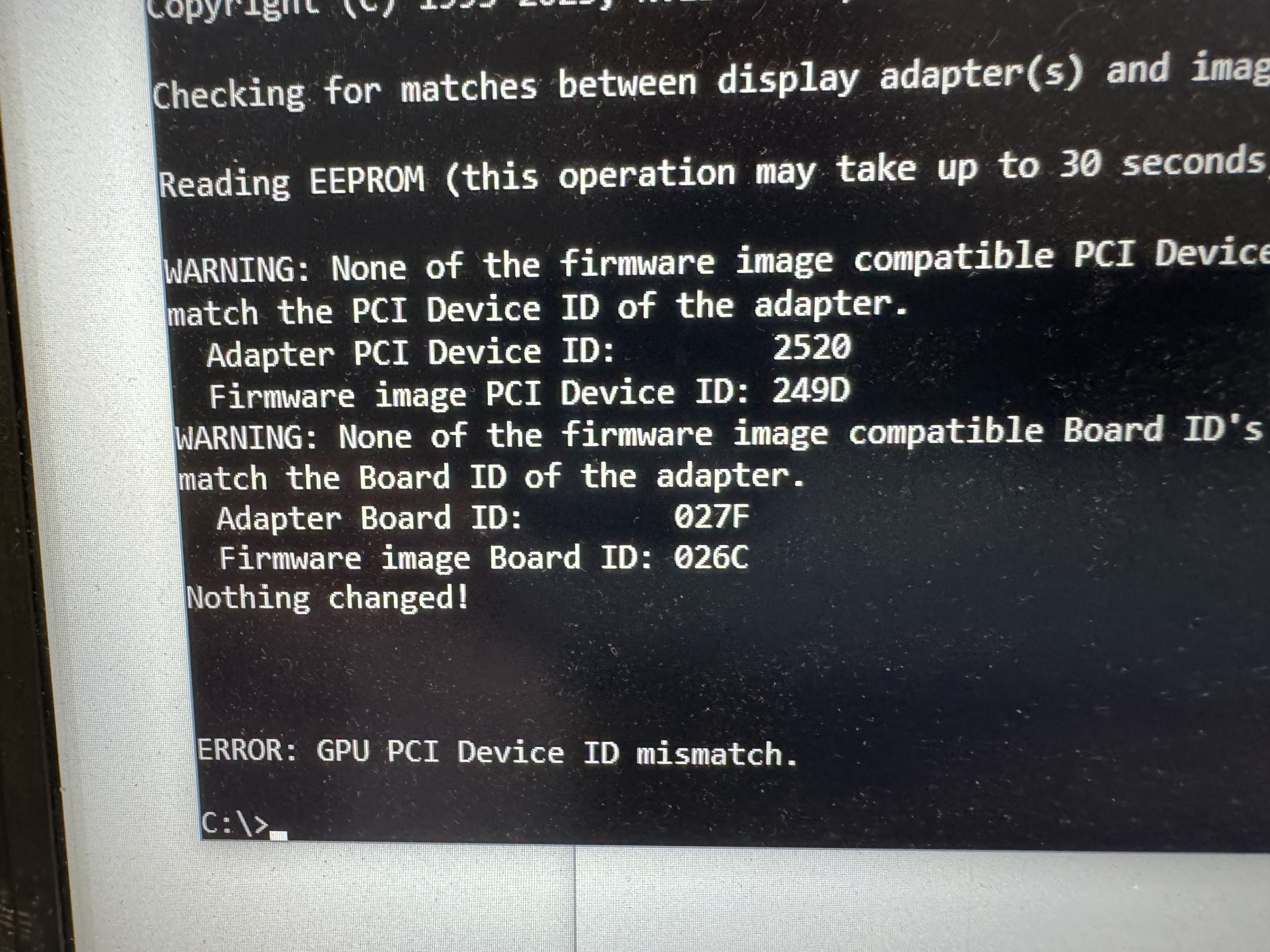

hello , i have a asus fx516pr rev 2 with subsystem id rtx 3070 but i have a 3060 on my board , can you modify vga bios subsystem id in the main bios?thanks
Badly same issue in the main bios subsystem id is 160c who is related to a rtx 3070 but on mine board its a rtx 3060
i can't edit it in bios
Just for you to know I found a other bios on badcaps forum for the same model I flash it on my laptop and now I have a subsystem id for a rtx 3060 :) in place of 160c I have 16e2 which is for an rtx3060 like on my board
