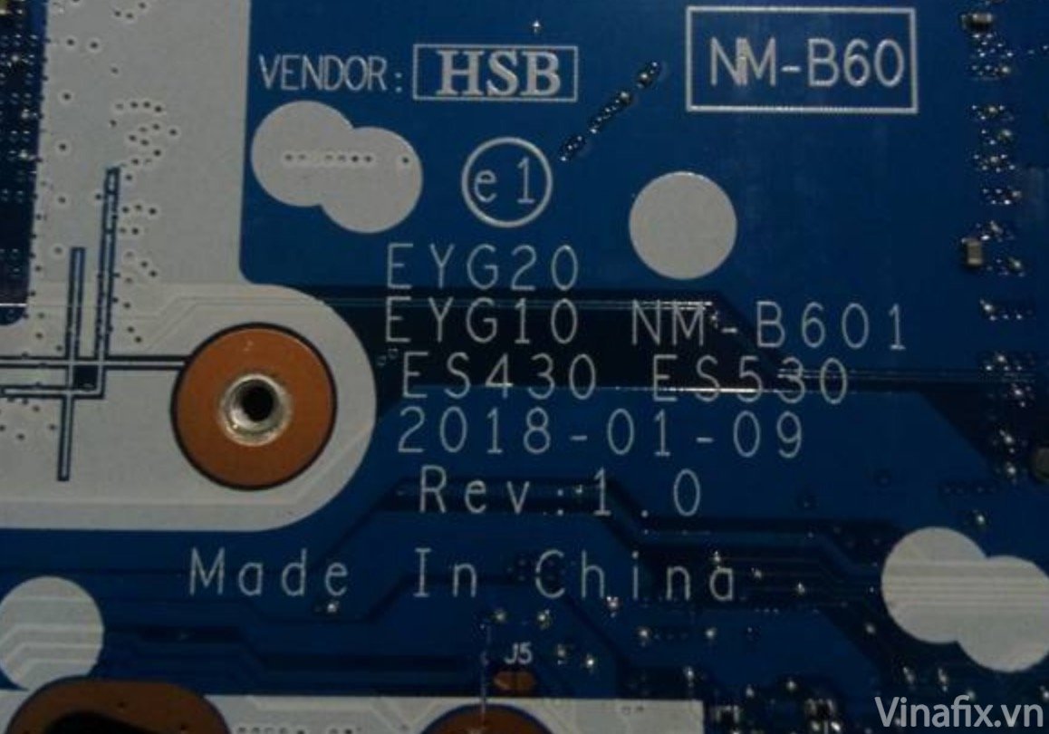

Hello, i am currently working on this logic board but have come across a stange problem: The laptop wont run/ charge from ac although it is recognized by the system when using a battery, when i move PR301 to the side so that the sensing circuit is open, it boots just fine... I have measured and replaced the resistor, the BQ24780 but it does not fix the problem, any idea what the problem might be?
