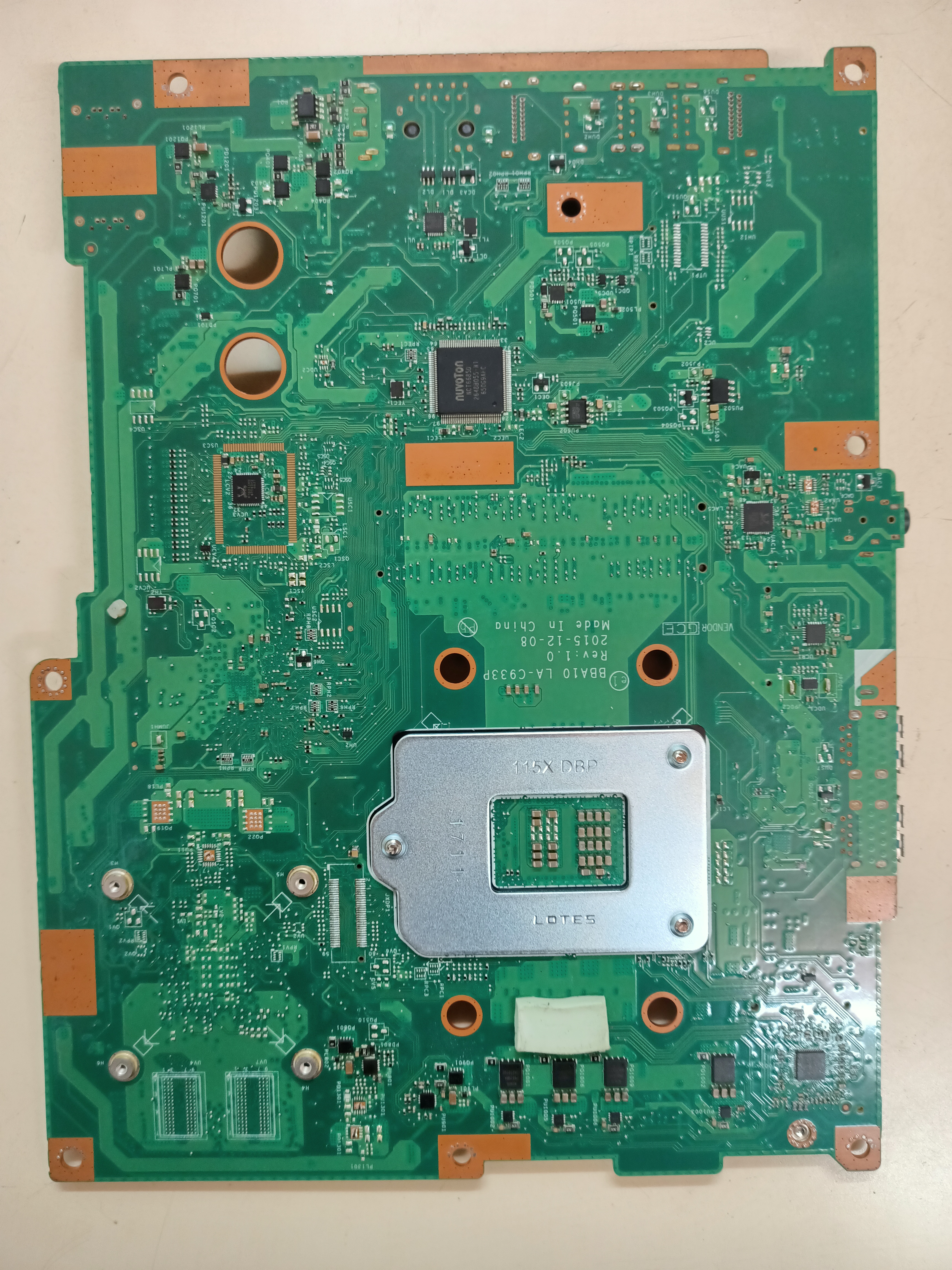

NOT working, black screenAIO 300-20ISH BIOS LA-C933P-REV1.0
old bios error what ?NOT working, black screen

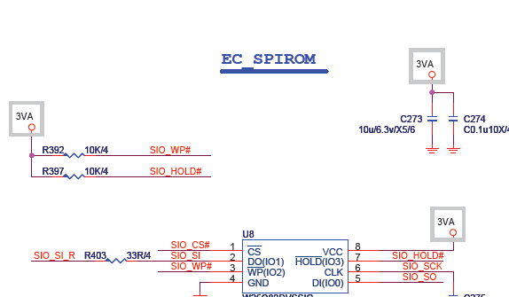

winbond25x10

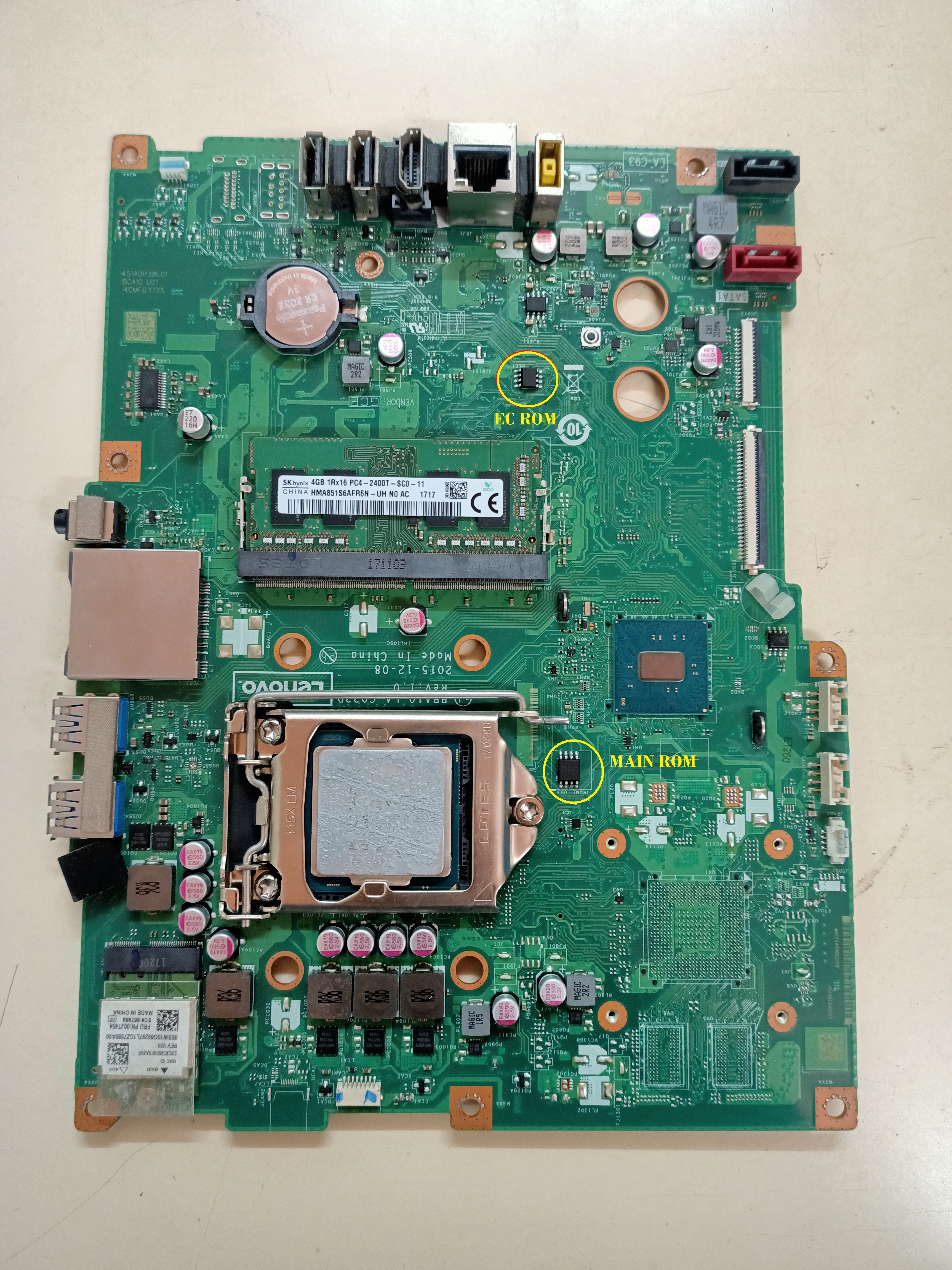

There is 2 bios ec bios is 128kb and main bios is 8mb
This is Read file of 128 kbyes, send file old i help builds
I checked it was not ECThis is Read file of 128 kb

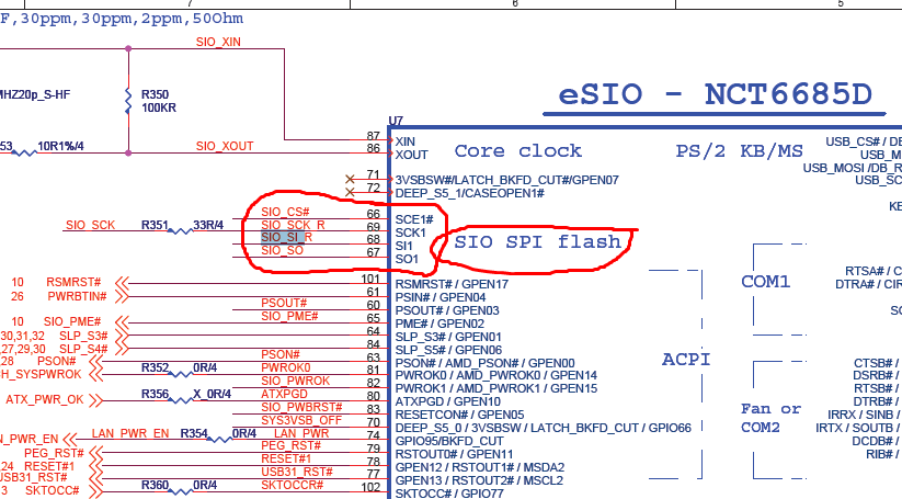

No sir , io is not programmable , but it's have external spi rom and it was an programmablethe motherboard is not as complete as the schematic, at the moment I don't have the information
in list tool Programming have name IO this ? can send one photo
As per this schema i checked continuty between the spi rom to sio and it's connected same as per appear in schemaHear posted images
