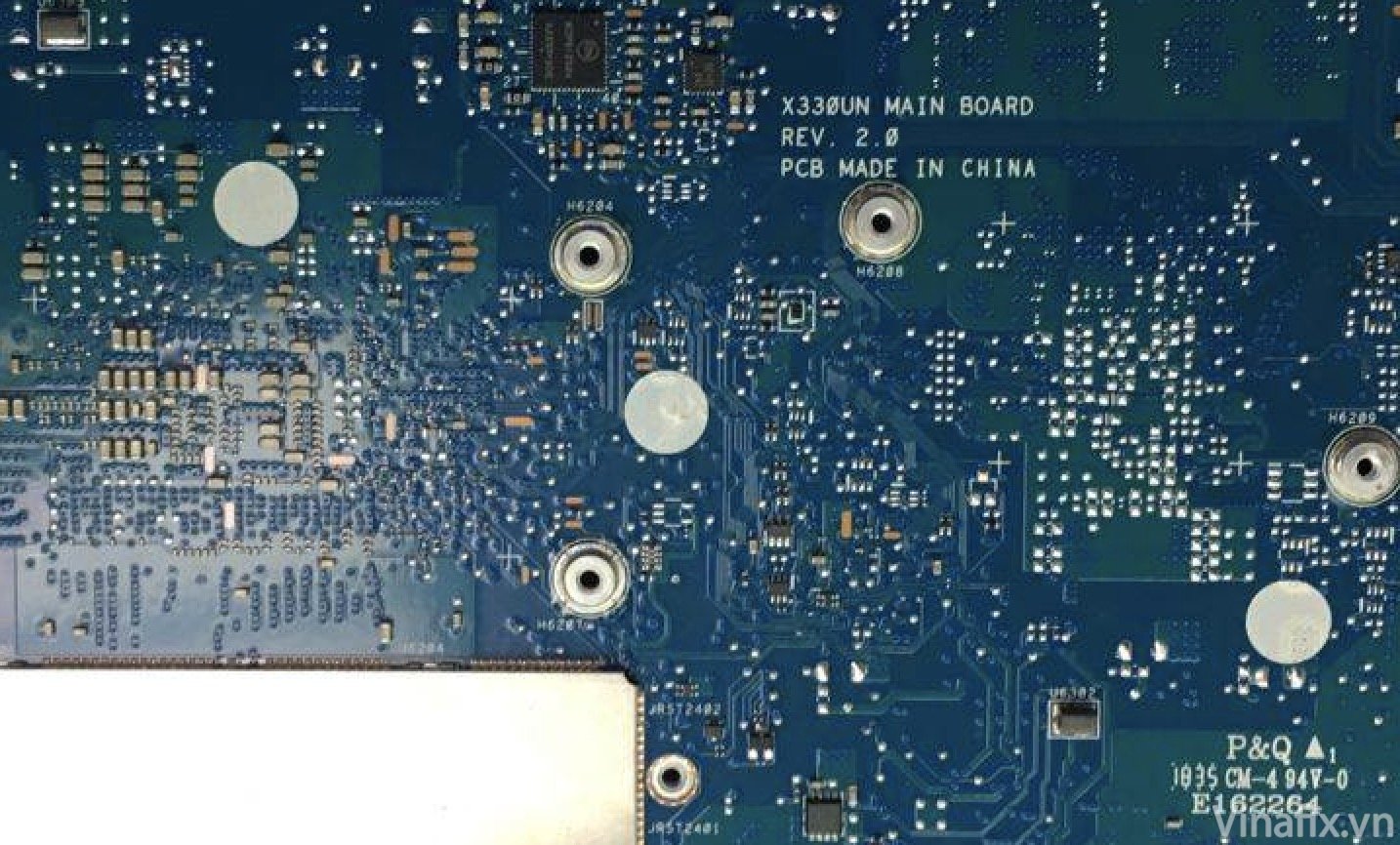

Thanks for BIOS dump. Is this dump fits to my X330UN with i5 processor?
I need boardview to repair this motherboard. And I try to understand - is there a bios cmos battery on this motherbord?
I have not EN signal on PWM NCP81236A
No care i3, i5 or i7
all same bios
