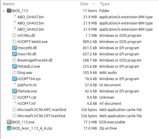

Same thing. No reaction at all, the original had keyboards light and fan spin.
What about the 1mb one? Maybe it's something with it?
backupEC.BIN
USING THIS FILE CAN'T BE ON AMPER IS ONLY 0.7, USING THE ORIGINAL BIOS THE AMPER IS STABLE JUST NOT DISPLAYED
There is 3 versions of this BIOS GH4UT / GH4U2 / GH4U3
GH4UT = no keyboard light no fan and shutdown
GH4U2 / GH4U3 = keyboard light + fan and shutdown
Pretty sure problem is not the bios more the EC but don't have a programmer.
Original BIOS posted here is GH4U3

Not working BIOS inside 1.13 GH4U2 not 1.13 GH4U3 not same or original cleaned.
Don't worry when it will be possible will try EC thank you
it's not GH4U2 sorry if it wasn't clear enough but
if you had opened original I sent inside it's GH4U3
I don't known but as you can see from the screenshot in the .exe of Asus
website there is 3 versions inside even bigger than the size of the chip.
From the dump of the BIOS I have and sent here mine is a GH4U3.
I'm waiting for EC programmer to arrive and confirm it's EC fault not BIOS.
