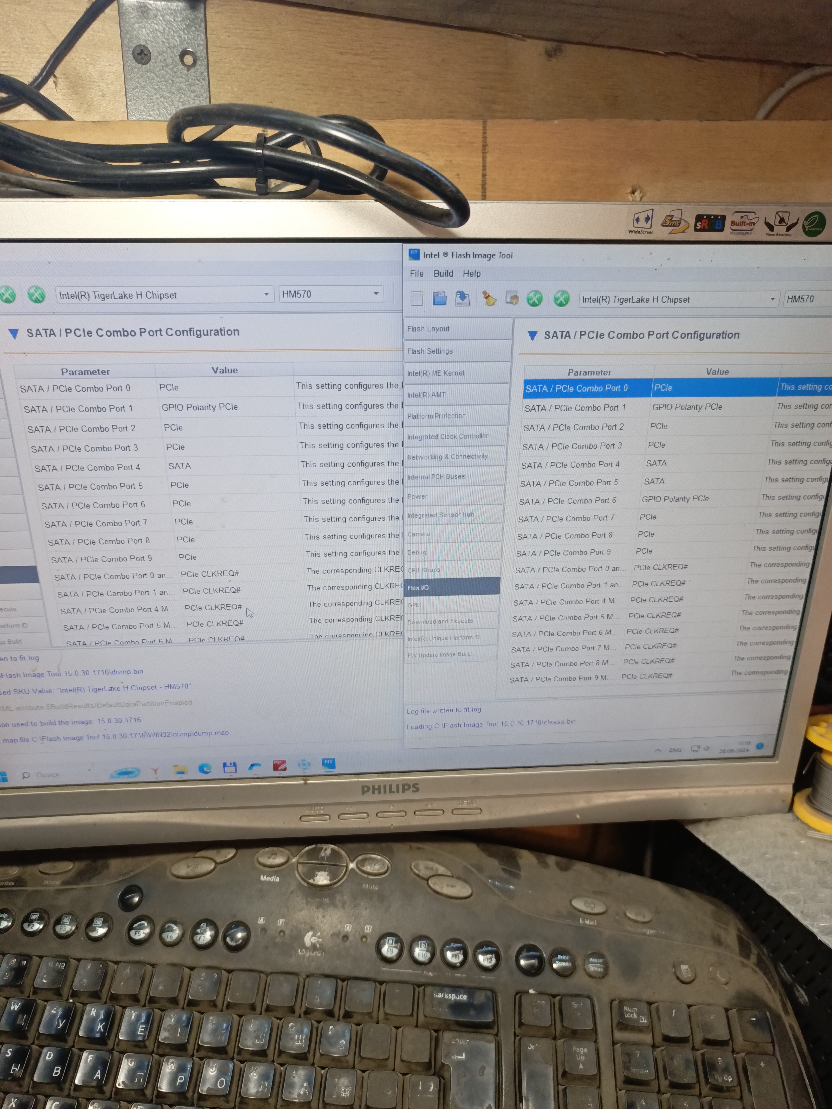

there is no way to check with SSD yet. NVME may not be defined due to different parameters in this section. My dump is on the left.On the right is your ClearME dump.
bios bad. nvme not work. I downloaded the acer bios from the website. prepared and stitched. and nvme is working)))) Thank you.
