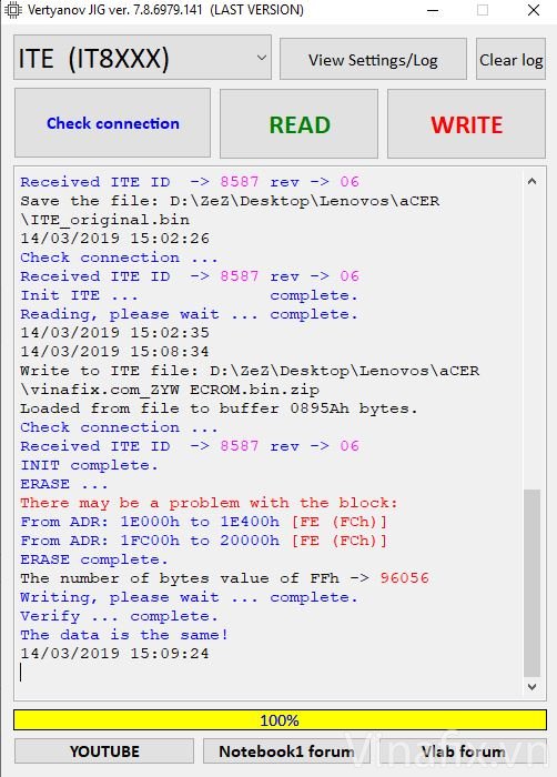

I have an acer e5-771 DA0ZYWMB6E0 REV:E turns on no image. All power rails up.
Ive tried to program EC and I got this error when erasing
This mean bad EC KBC chip?
