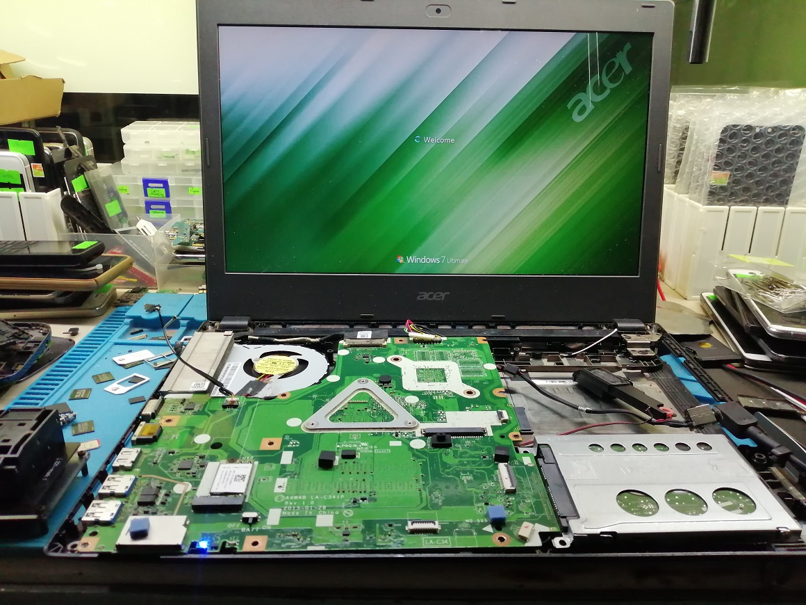

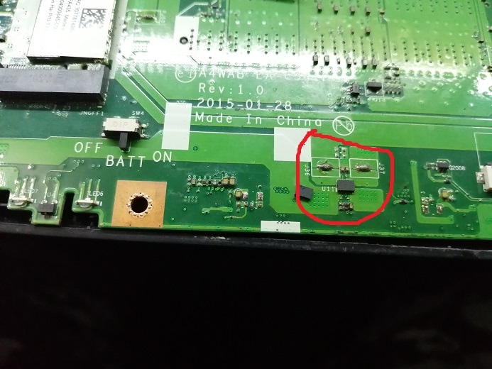

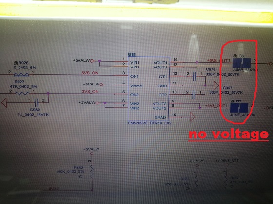

mel_chen Registered member Nov 3, 2019 #1 Hi to all ... im new here i want to share Acer aspire E 14 NO power ... Done 1st - clean 2nd - check voltage 3rd - change u11 ic ( no voltage output ) thank you Download list Upvote 0 Downvote
