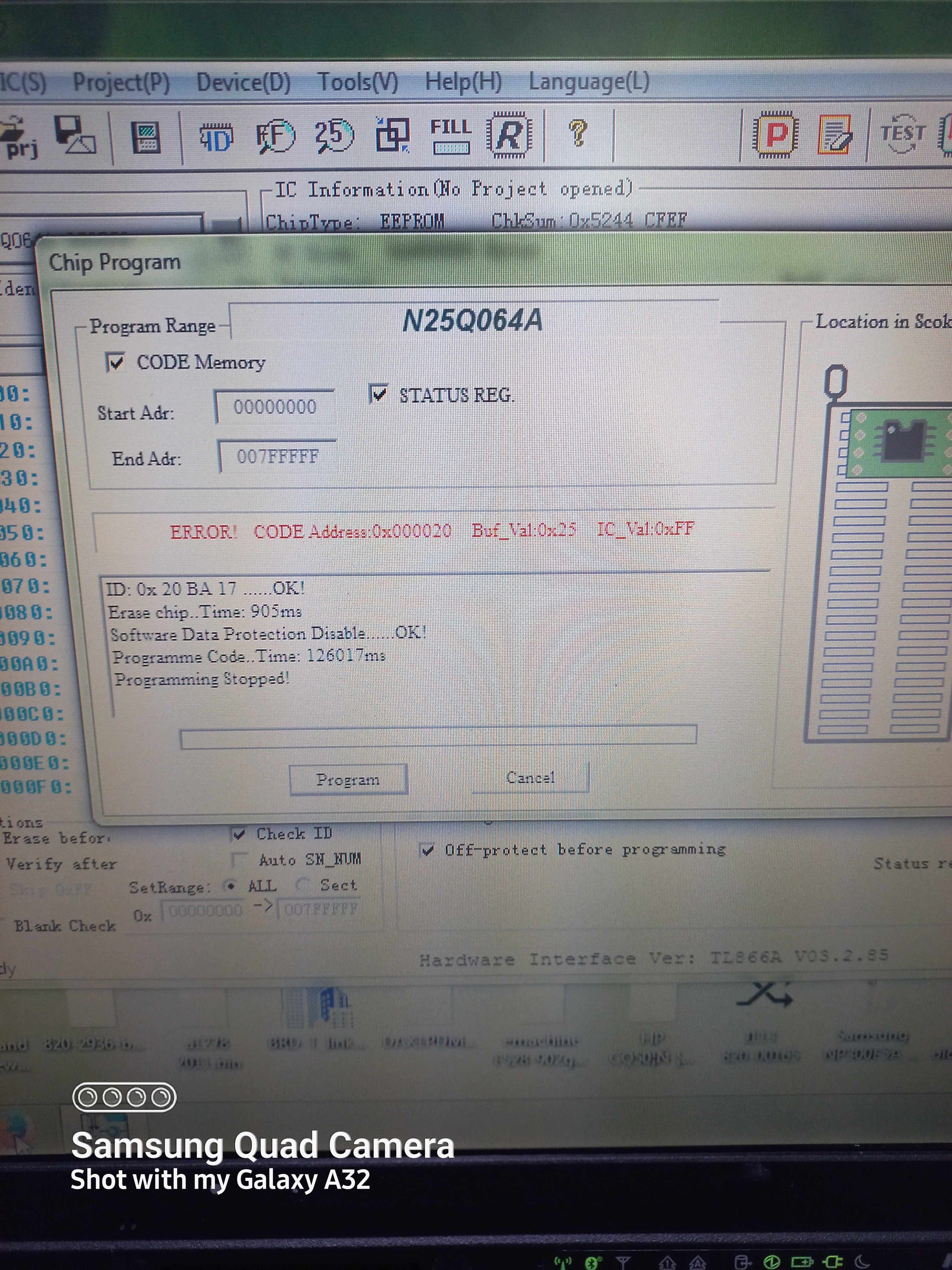

is it common for the hard drive to not appear after flashing firmware? I removed the firmware chip for this one, and used the TL866ii Plus, flashed 820-3208-a ok.bin. It now boots with option key and allows me to see external drive options but the original internal drive doesn't appear
no that usually doesn't happen after BIOS programming
