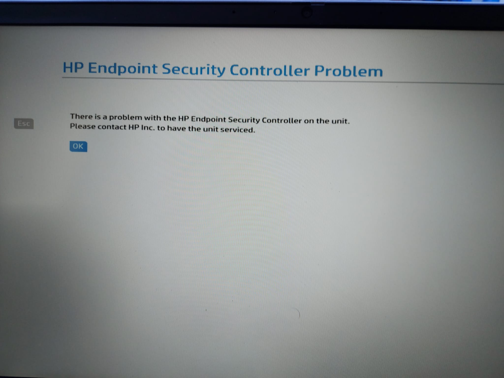

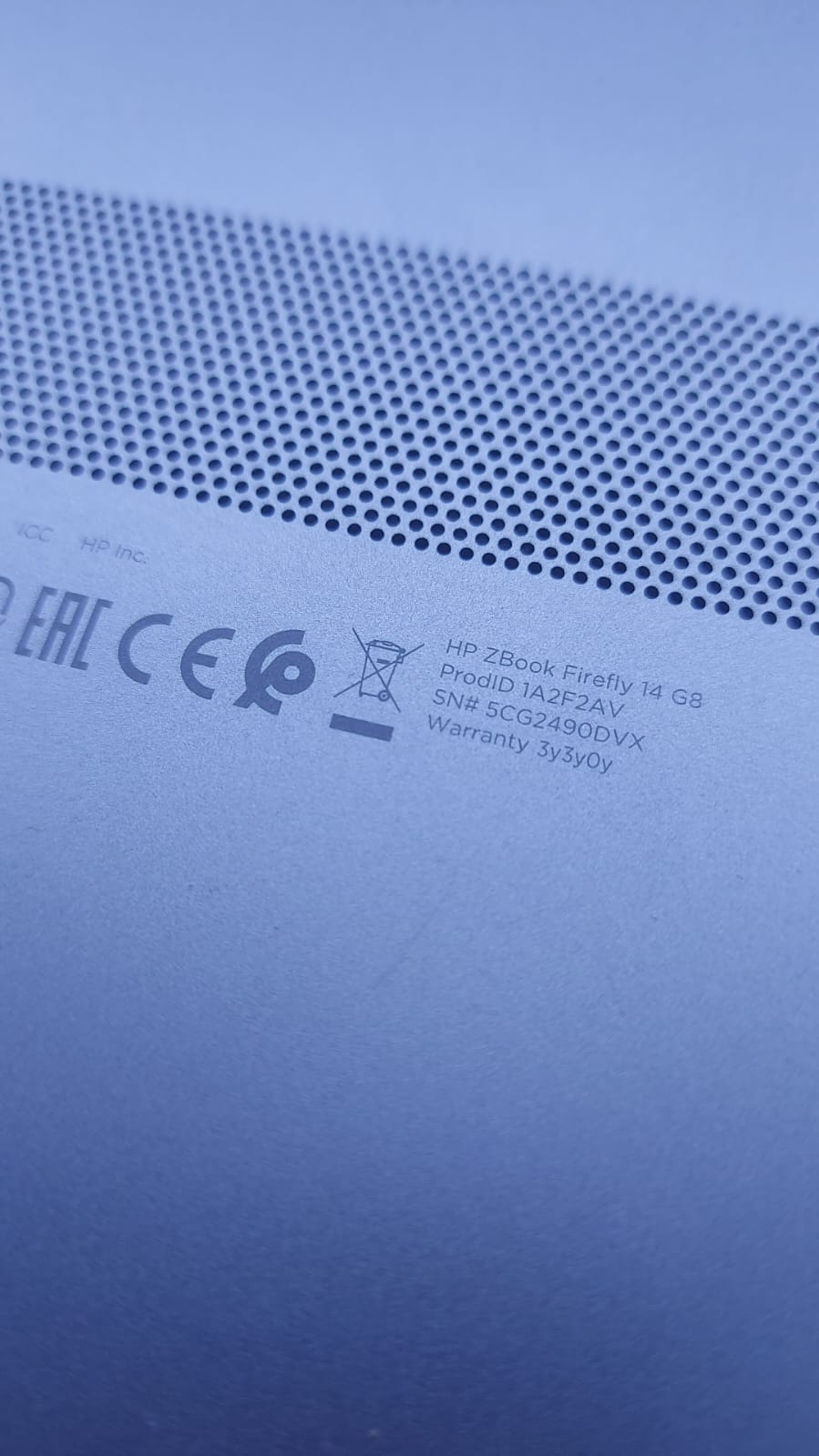

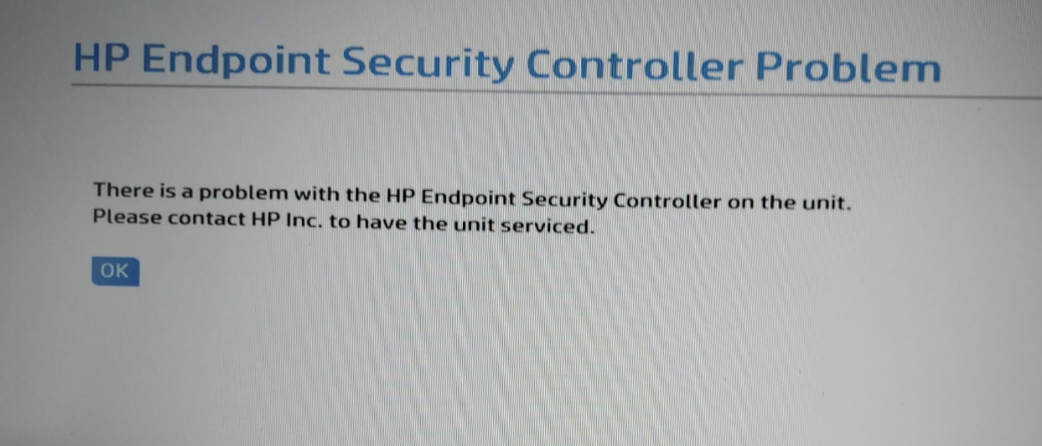

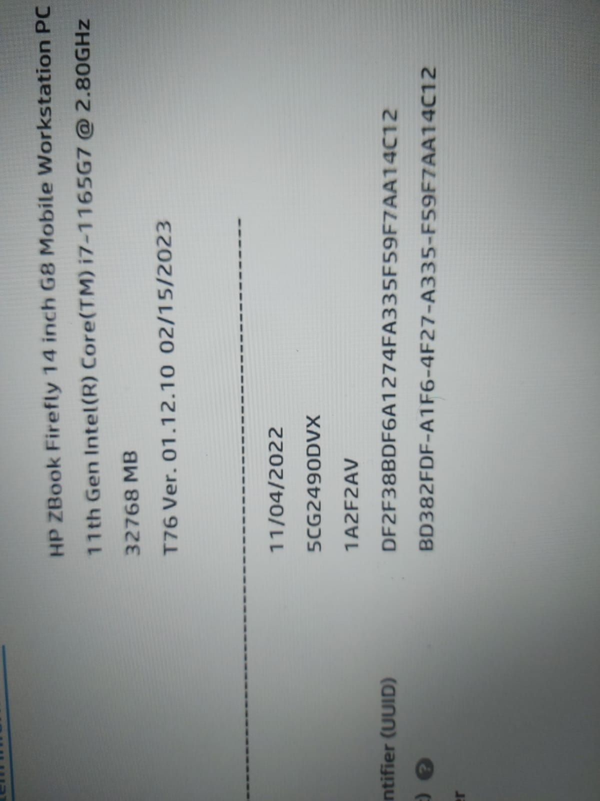

file this right
20230428_144045_SVOD4.bin
s/n ( 5CG2490DVX )
but file 2end not right
2end use s/n 5CG133324J
That's why the security error appears
