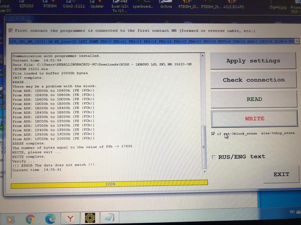

hi, please clear me, 700-17isk 15221-1 my error: Unable to open file: C:\Users\Uzivatel\Desktop\Flash_Image_Tool_v11.8.50.3460\700-17isk.BIN. Reverting to default configuration.

now board only start 0,5s 0,27A and shutdown, with no touch bios start and have 0,27A
I changed PCH -> ME must to be clean
I cannot program IT8226E, its seem like security against flash
when i erase bios + ec then read ec it have data, how it works?
Check connection ...
Received ITE ID -> 8226 rev -> 01
INIT complete.
ERASE ...
There may be a problem with the block:
From ADR: 1D000h to 1D400h [FE (FCh)]
From ADR: 1D400h to 1D800h [FE (FCh)]
From ADR: 1D800h to 1DC00h [FE (FCh)]
From ADR: 1DC00h to 1E000h [FE (FCh)]
From ADR: 1E000h to 1E400h [FE (FCh)]
From ADR: 1E400h to 1E800h [FE (FCh)]
From ADR: 1E800h to 1EC00h [FE (FCh)]
From ADR: 1EC00h to 1F000h [FE (FCh)]
From ADR: 1F000h to 1F400h [FE (FCh)]
From ADR: 1F400h to 1F800h [FE (FCh)]
From ADR: 1F800h to 1FC00h [FE (FCh)]
From ADR: 1FC00h to 20000h [FE (FCh)]
ERASE complete.
The number of bytes value of FFh -> 7888
Writing, please wait ... complete.
Verify ...
ERROR (SRC-source DST-destination)
(first 256 bytes)
ADR 1D000h SRC=BCh DST=FFh
ADR 1D001h SRC=90h DST=FFh
ADR 1D002h SRC=F5h DST=FFh
ADR 1D003h SRC=90h DST=FFh
ADR 1D004h SRC=2Eh DST=FFh
ADR 1D005h SRC=5Eh DST=FFh
