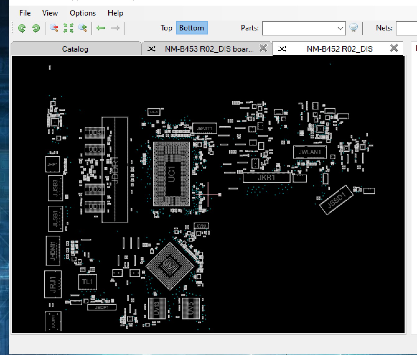

boardview NM-B452 R02_DIS

NM-B452 R02_DIS.tvw.zip

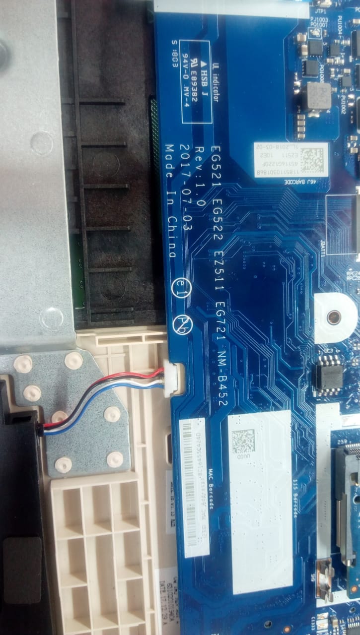

no display with bios from all theme. With old one have display but after shut down dead. Need to disconnect baterry and rtc and start again until next shut down.
I also solved this problem. This is a problem with the EC Bios program. In my case, NM-B452, the problem was solved by programming the IO chip
