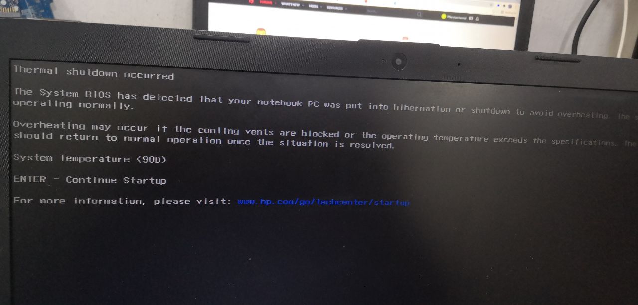

after bios reflashed display ok with in 4 seconds , but theermal shutdown showing can u rebulid the bios again
th

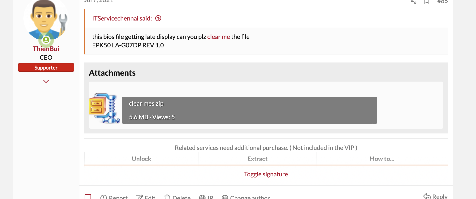

try BIOS other and compare
and
need to check the heat problem
Not sure if the problem is coming from the BIOS so clear me doesn't solve the problem
thanks for support sir .. sys getting normal heat , cooling fan replaced now working fine. and once again thank you so much
