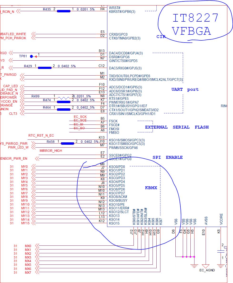

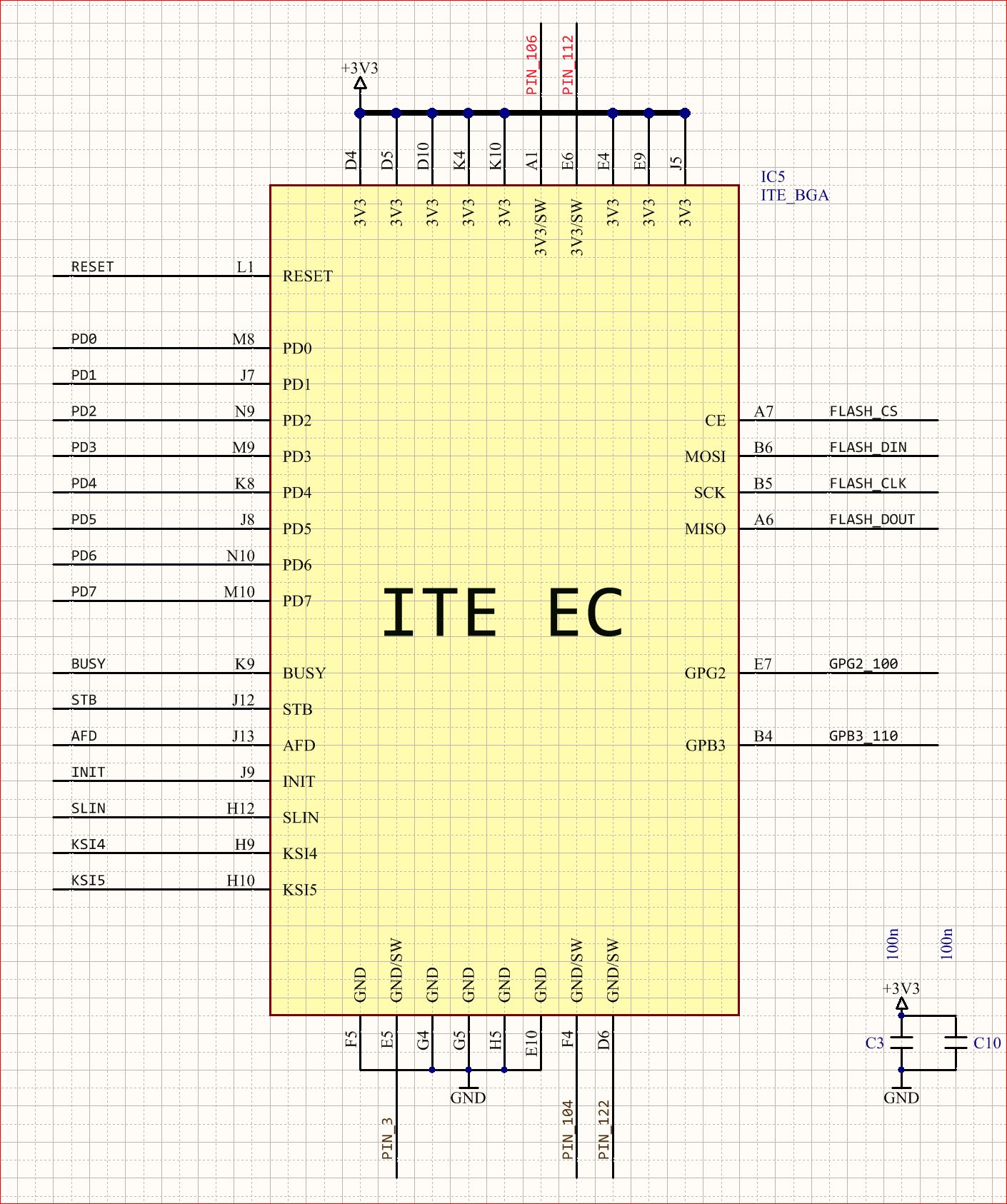

PD0=13 PD1=17 PD2=19 PD3=24 PD4=20 PD5=16 PD6=23 PD7=21 BUSY=10 STB=18 AFD=7 INIT=14 SLIN=15 KSI4=11 KSI5=12 IT8227E-128
what pins are KSO0-9 and what KSI0-5 ???
Also it8227vg-128 is BGA not QFP. and probably keyboard pinout are different on every laptop model
