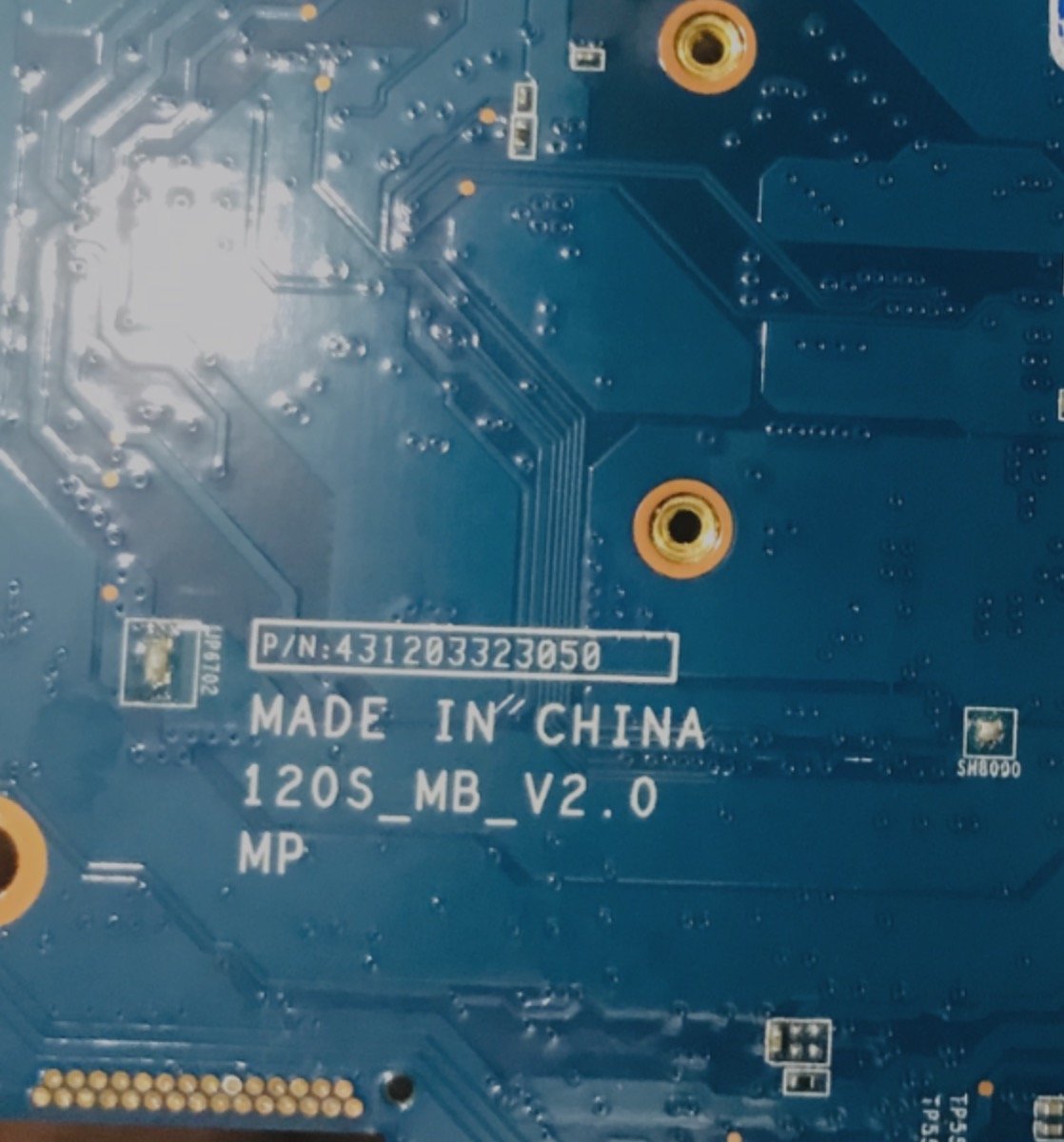

hello, I will be grateful to know the beginning and end address to program DMI information into EC..
Hello EC is KB9028 for motherboard 120s_MB and I have replaced with new one .. I have programmed it and it works but could not retrieve bin from the old damaged EC, so DMI data is invalid in new programmed EC. If I get EC bin from similar working laptop, I will be able to locate DMI address location..
you need use tool i send above add info
There is no other solution
