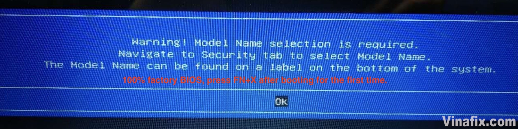

100% factory BIOS, press FN+X after booting for the first time.
Pressing Fn + X key should remove the message. If it doesn't, then try the following steps.
Reset BIOS settings to defaults.
  • Power off the computer
  • Restart the computer, tap ‘F2’ key on the Dell logo
  • This will take you to the BIOS screen
  • Press ‘F9’ key once, highlight ‘Yes’, press ‘Enter’
  • Press ‘F10’ key once, highlight ‘Yes’, press ‘Enter’
