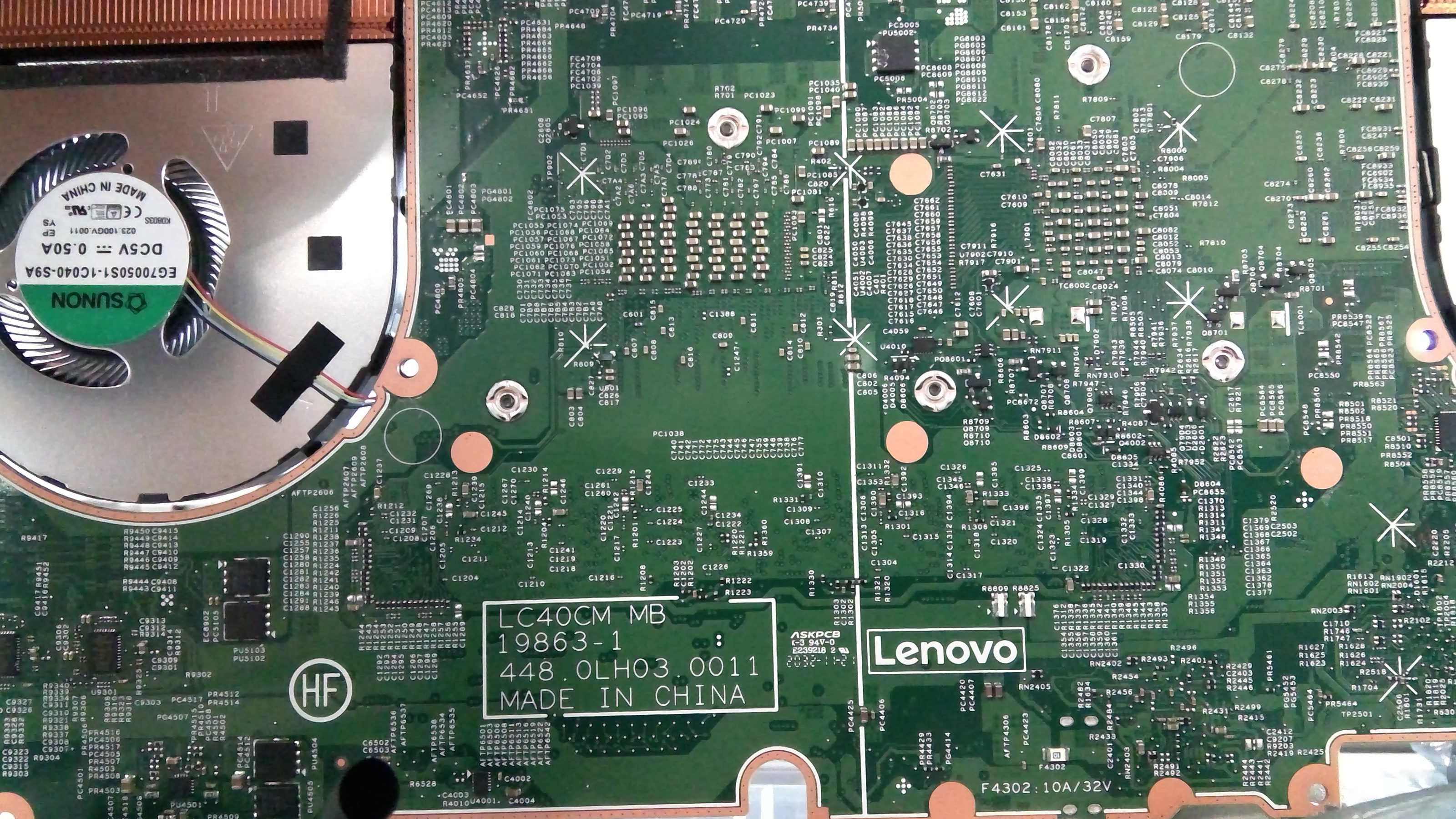

Yoga 9-15IMH5 Laptop (Lenovo) - Type 82DE 19863-1
if you provide a full size BIOS I can help clearme
i cant do anything with BIOS update it only use in window.
I help clearme file this
R910QXMD.
Unfortunately this bios "clearmes" has a black screen and caps lock is on. On the original "R910QXMD" a long turn on is about 30-40 seconds, the laptop is working and after turning it on it works absolutely fine.
If it's the original BIOS, there can't be a delay error
unless the hardware has changed or has not been fixed before?
