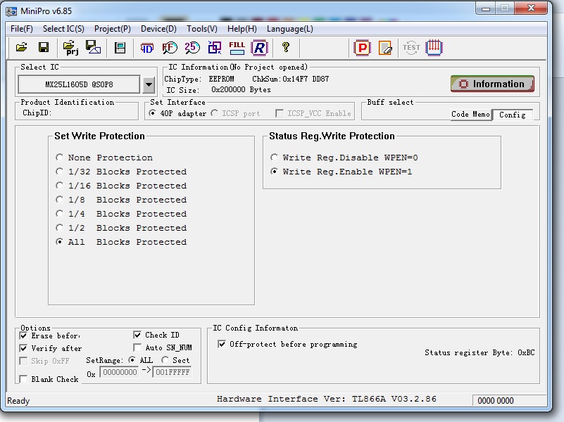

I CAN NOT ERASE THE CHIP !
I DON'T UNDERSTAND WHY I CAN'T DELETE THE CIP, FOR SAVING DATA I CAN
I HAVE TWO PROGRAMMERS MINIPRO TL 866A AND EZP2010
WITH ANY OF THE PROGRAMMERS I CAN'T DELETE CIP
I MAKE THE DELETE CIP IS FINISHED WITHOUT ERROR, WHEN DATA READ CIP HAS DATA

in the programming software interface, check if it is write- and delete-protected. ( protected )
