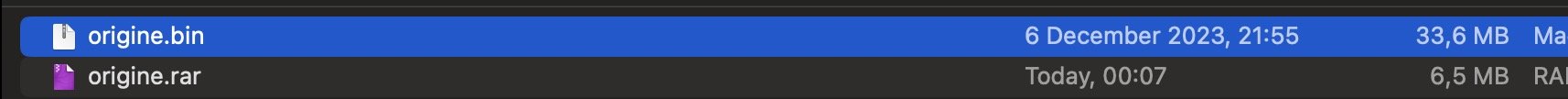

This is not a problem with the bios filei got flash error every time i made to verify the flash maybe bad chip?
Which programmer to use to program a 256mb ic?mine is only 64mbThis is not a problem with the bios file
Bonjour , j’ai un problème avec un bois corrompu pour une asus z790 Maximus hero , la puce bios est une mx25l25673gz4i-08g , pouvez vous programmer ce genre de chip bios ?merci
no, I check file BIOS old you send 32mb. I think you are not techn
I just don’t understand why it’s not working the ic is mx25l25673gz4i-08g ,so I think it’s a 256mb ic , every time I want to program it I have an error , yes the bios file is 32mb but on internet it’s says that the ic is a 256mb programming ic , so I think my tool to program is not compatible with this kind of ic because it can only go to 64mb ic , I’m right no?
I have an ez2023+ very cheap for sure but worked fine since 1 yr I will look for a better one , but do you have one you can suggest for me ?i know the svod4 is good but very expensiveThrow that tool in the trash and buy a new one
