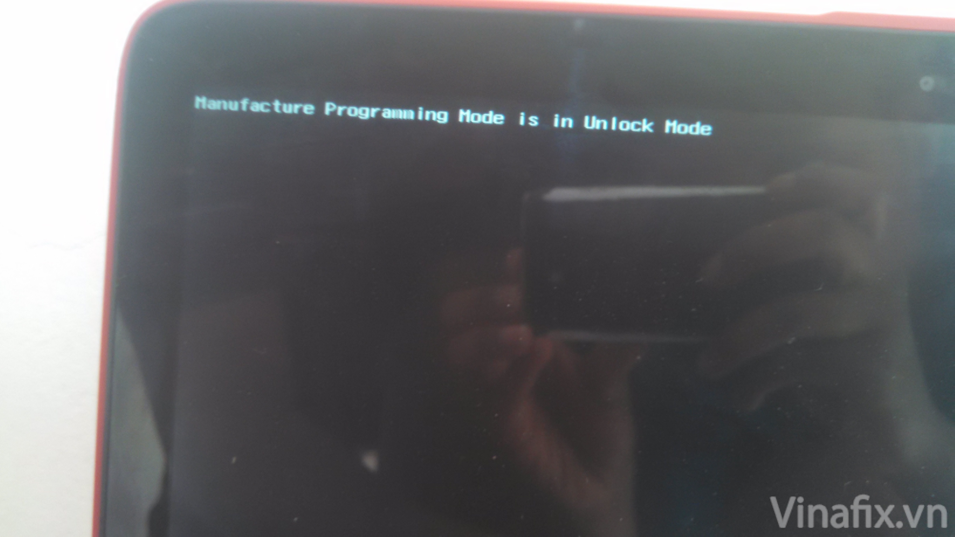

Manufacture Programming model is in unlock model
ThienBui
Techniques
Supporter
"manufacture programming mode is in unlock mode"
Go to hp website and download the BCU (BIOS configuration utility) sofware. (works with win xp,vista,7,8)
ftp://ftp.hp.com/pub/softpaq/sp63501-64000/sp63610.exe or http://ftp.hp.com/pub/caps-softpaq/cmit/HP_BCU.html
HP BIOS Configuration Utility (BCU)
After you dowload it, install it and go to installation link.
C:\Program Files (x86)Viewel-Packard\Kos configuration utility
Now open cMD(comand promt) by pressin wiN+R->cmd->Enter.
Now type in CMD the followinf comand:
1: cd c:\Program Files (x86)Viewel-Packard\Kos configuration utility
2: Biosconfigutility64.exe/getconfig:config.txt
Don't close the CMD.
Go to :
c:\Program Files (x86)Viewel-Packard\Kos configuration utility There you would see the config.txt document. copy it to Desktop, open and edit Manufacturing Programming mode
( by erasing the " Next to unlock and typing "0" nex to Lock):
From :
Manufacturing Programming Mode
*unlock
Lock
To:
unlock
*Lock
Now save the chnges you made in txt file, copy the config.txt back to c:\Program Files (x86)Viewel-Packard\Kos configuration utility . Now back to cMD(command promt)
type in:
Biosconfigutility64.exe/setconfig:config.txt
close the CMD and you are DONE.I

mình fix trong Win luôn hả anh, em cảm ơn ạ
tải file ko có sn về nạp vào rồi muốn làm gì thì làm.
tool thì có tool this
xem có chạy ko
