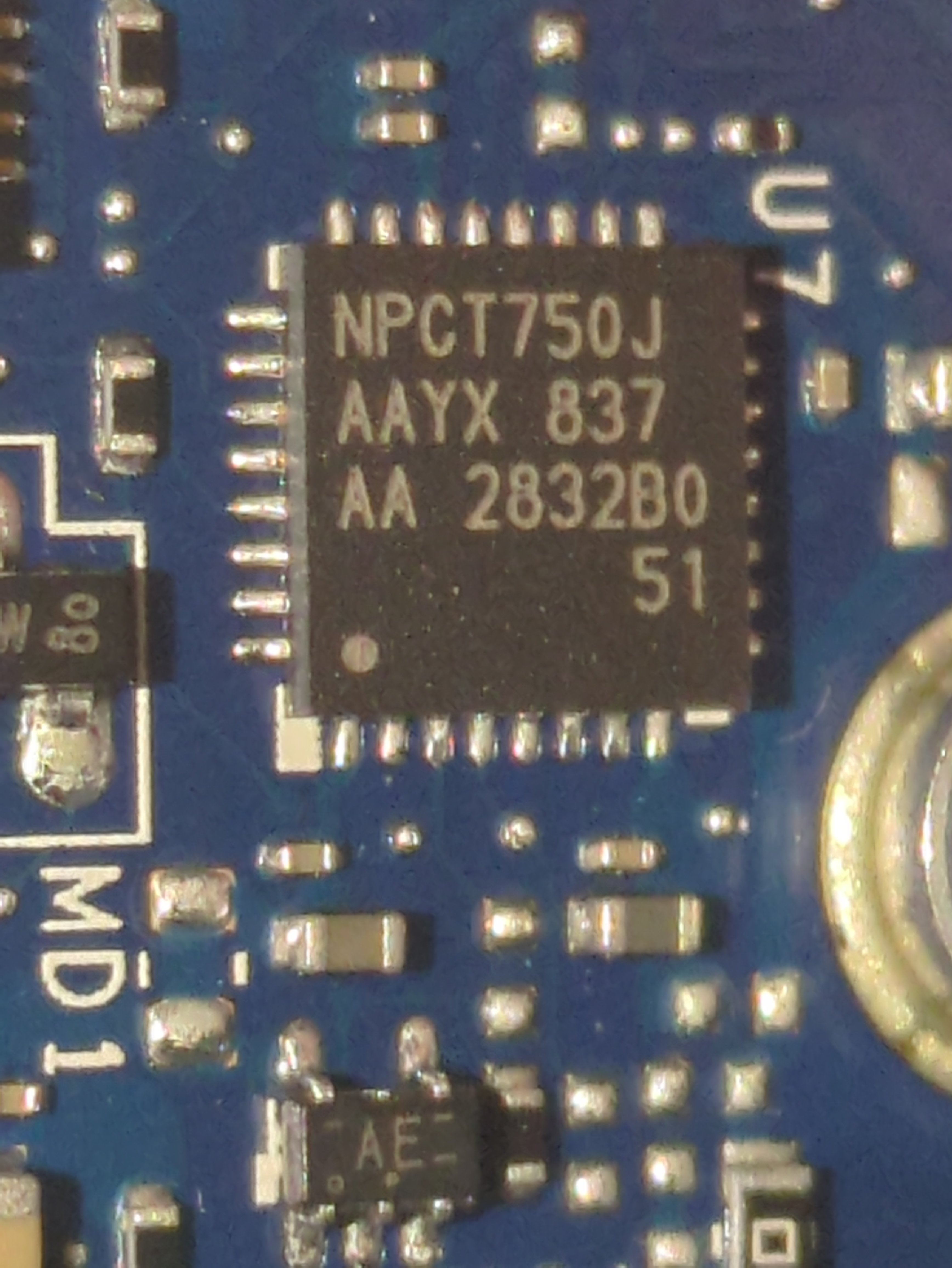

Purchased new motherboard on eBay for 9370 to upgrade from I5/4GB to I7/16GB.
New Motherboard works good and was new (had to enter service tag) but no TPM detected in BIOS or in O/S. TPM chip (U7) is present on board, but the select resistors RH71 & RH72 are on the back side of board. Try to avoid pulling board to look.
Any program to see status of TPM_DET signal on (GPP_B19/GSPI1_CS#) pin of CPU?
Thanks

You need to check everything works normally before patching and removing TPM
I am not looking to REMOVE TPM.
I want to ACTIVATE TPM. TPM Chip is there but not present in BIOS menus.
