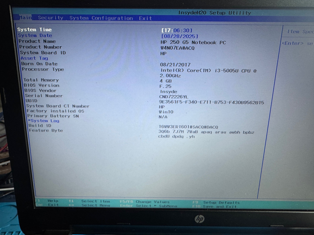

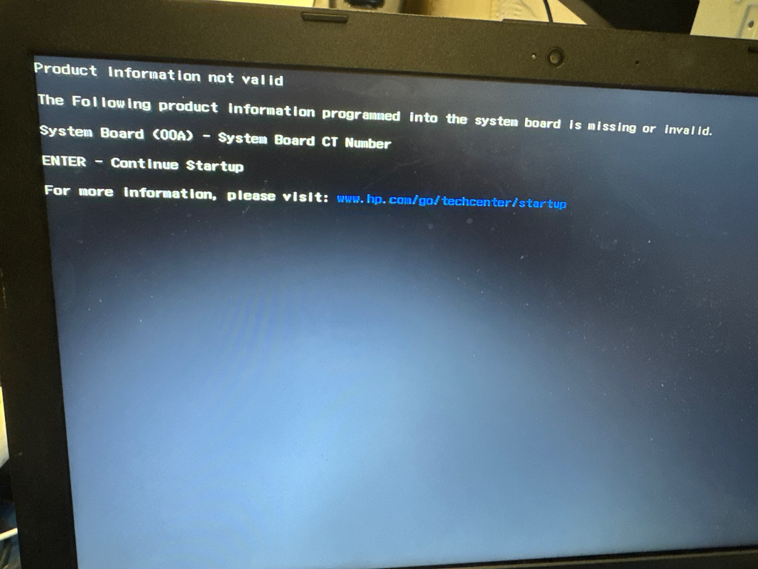

Hi, how to change CT number i try use many programs to edit DMI data but i always have error like on photo and can’t change any thing i change bios but canot program dmi data

and what is in DMI after i use BCU :
English
; Settings file originally created by BIOS Config Utility
; Version:3.0.13.1
; Date:2025.08.28
UEFI Boot Order
OS Boot Manager
Internal CD/DVD ROM Drive
USB Diskette on Key/USB Hard Disk
USB CD/DVD ROM Drive
Network Adapter
Legacy Boot Order
Notebook Hard Drive
Network Adapter
Feature Byte
3Q6b7J7M7WaBapaqasauawbhbpbzcbdUdpdq.52
Build ID
16WW3ERT601#SAKD#DAKD
SKU Number
X0P79ES#AKD
Serial Number
CND6500B6W
Product Name
HP 250 G5
UUID
03112E1107E9081C1122EC8EB50C37A2
Mac Address
EC8EB50C37A2
System Board CT Number
B FXXH A0 M2 53 AL4
Keyboard Type
00
MS Digital Marker
010000000000000001000000000000001D00000037335846422D594E4852542D33334A57502D54465632482D48584D4B33
System Board ID
ž›
Asset Tag
X0P79ES
System Family
Preinstall OS Version
WIN
can the KBC chip be broken in that way to make error CT ?? i programming ENE and no error was after read or write ?? help ??
