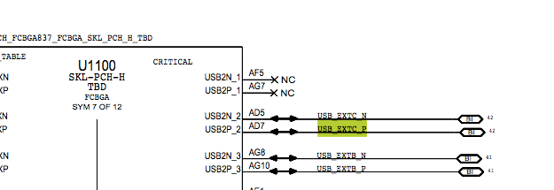

I have an iMac, which customer says made a boom sound, and never turned on; board show no diagnostics lights. I inspected the board and it seems the 3rd USB port from left (looking at the back), had some issue, resulting in burn out of:
1. L4702 (dual filter) that carries the P and N channels of the USB.
2. L4701 - likely delivers PP5V_S4 to the USB.
3. U7700
Now, I am not sure if this could have caused the PCH to die as L4702 connects the USB to PCH. U7600 is not generating PP3V_S4 or PP5V_S5. PM_EN_REG_P5V_S4_R has 0.4v.
I removed U7700 to see if it may help; but still no diagnostic lights. Any ideas?
Thank you!
