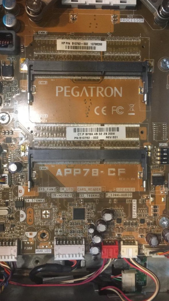

APP78-CF (Jesse)
BIOS JES5.12
  • Manufacturer: Pegatron APP78-CF
  • HP/Compaq name: Jesse
JES5.12.bin.zip
Excuse me Thien, the programmer had recognized me another type of 8MB chip. Flashing the bios above.
bios this not right. name chip bios this ?
and you need check again, 8mb bios only available on core i platform or above....
I had selected in my programmer, 25..080.
Automatically I have 25..064.
It's the fault! It was confusion. It's already working, thanks!
