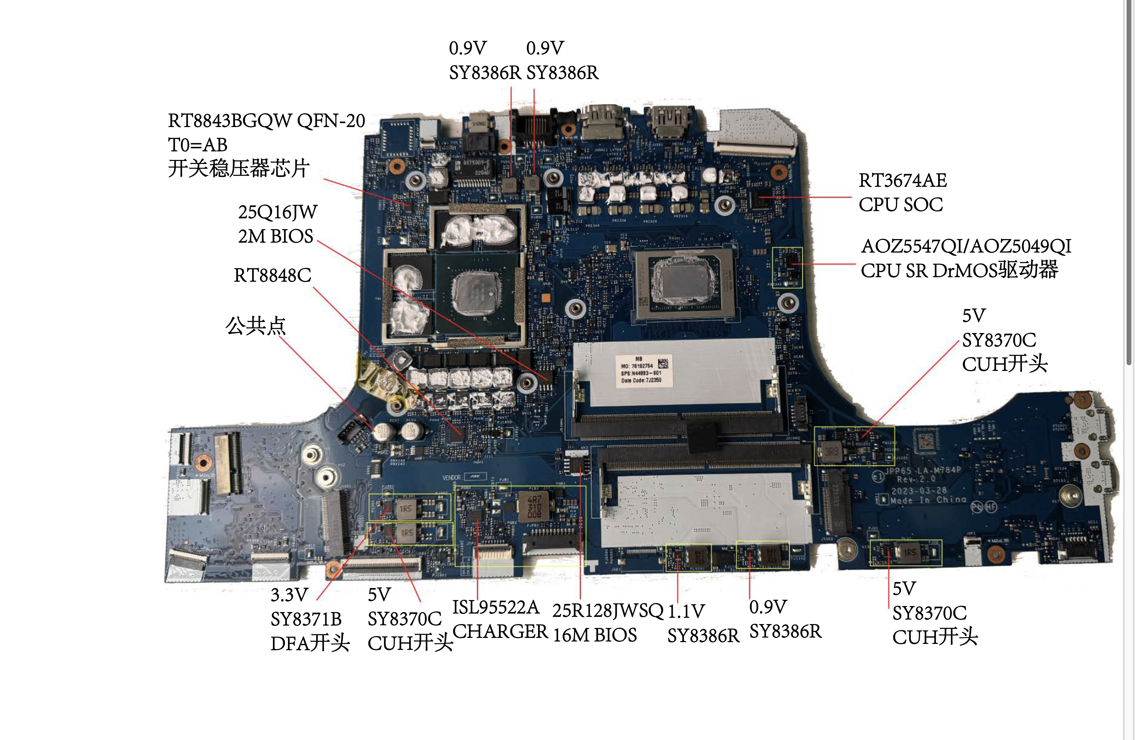

LA-M784P Rev 2.0

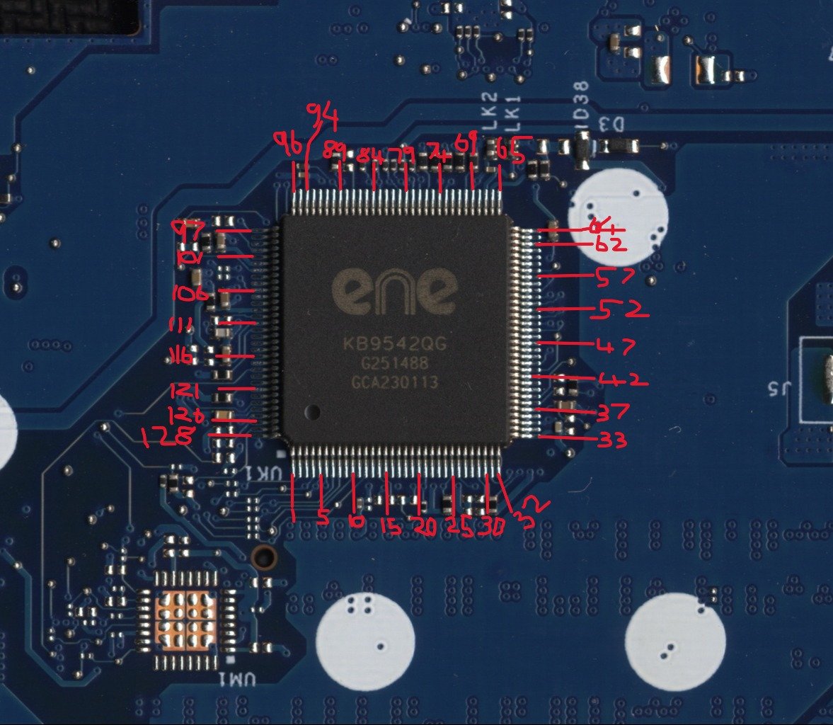

Hi thank you for this. LA-M784P KB_pins=32 LEFT DOWN 05MM KSO3=20 KSI4=5 KSI7=26 KSI6=25 KSI5=24 FLASH=160 CHIP=KB9542QG on the attached which pins would it match up toHP Omen 16 - JPP65 LA-M784P BIOS

LA-M784P REV: 2.0
Please buy 1 VIPHi thank you for this. LA-M784P KB_pins=32 LEFT DOWN 05MM KSO3=20 KSI4=5 KSI7=26 KSI6=25 KSI5=24 FLASH=160 CHIP=KB9542QG on the attached which pins would it match up to
