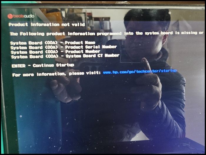

Hi, help please
hp omen 15-5251ur (board: reacher 142412-2 MB 448.02Q04.0021)
The laptop was fully functional until the battery was connected backwards
The chipset and BIOS flash drive burned out
original bios flash is damaged and dump not avaliable, was changed chipset
now I have problem with black LCD
The laptop turns on, the keyboard backlight works, the hall sensor responds to closing the lid, the cooler works, but there is no image
current consumption is about 1A
dumps from official site extracted and from this topic - same reaction
