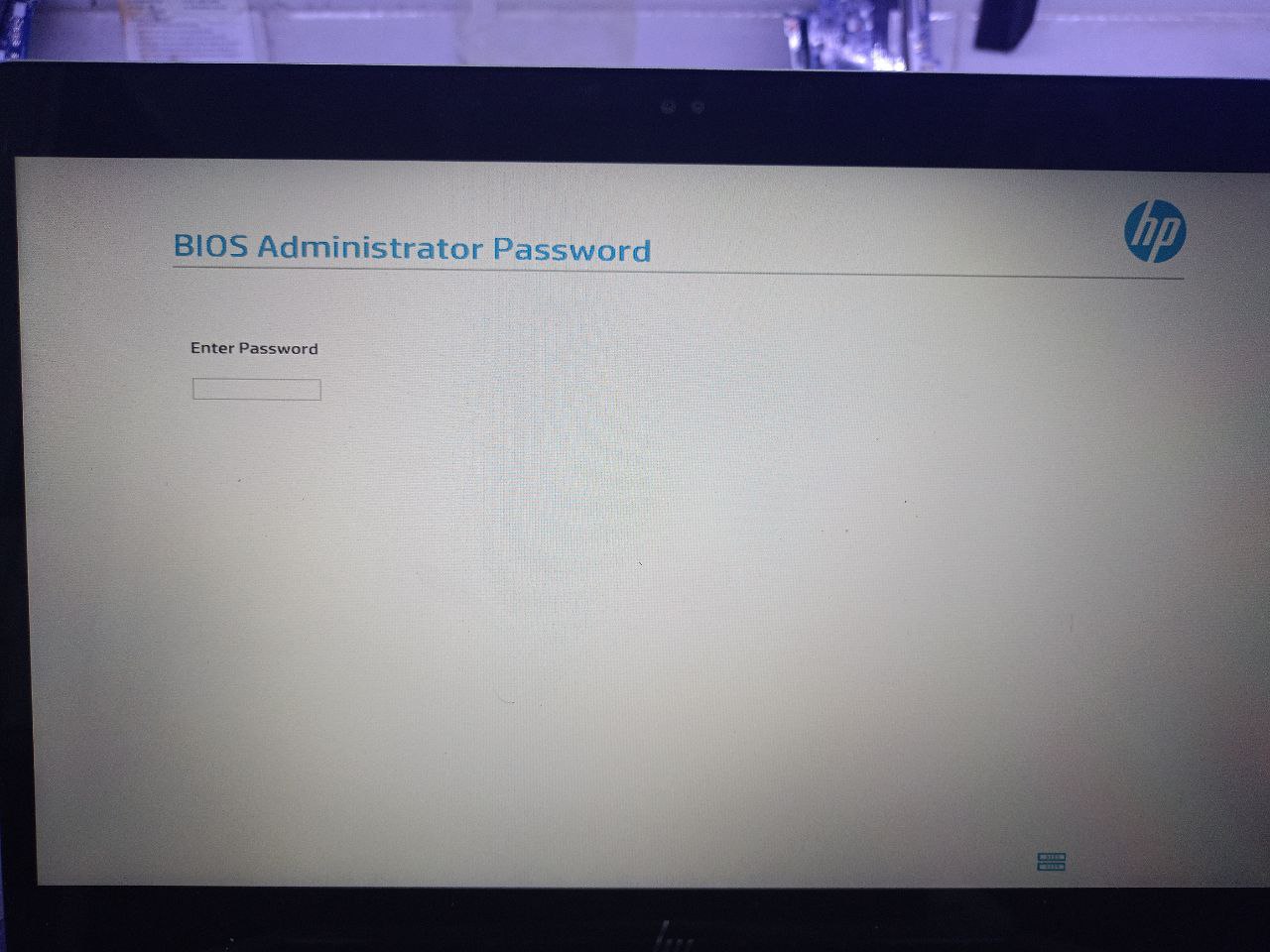

I flashed it but it still asking for password when i tried to enter bios setup.
I tried as password 89222 and unpas89222 but it still does not accept it. ( if the name was a password and not a random number).
I tried a different bios from an other post but still ask for password so i found the 2nd chip probably the EC and took a backup. Probably the password prompt is in there. Here is the backup form the 2nd bios chip. I hope it will help you to remove the password.
[email protected]

So any ideas why it did not remove the password?
When i flashed the bios you send me, on power on it showed EC missmatch so it did a quick update and rebooted.
Thats why i thought it could also have some code in the 1mb bios so it still asks for a password.
"the computer will boot in to windows the problem is when you try to go in to bios manu thats where is will ask for password"

That's what you think, it's not like that. e

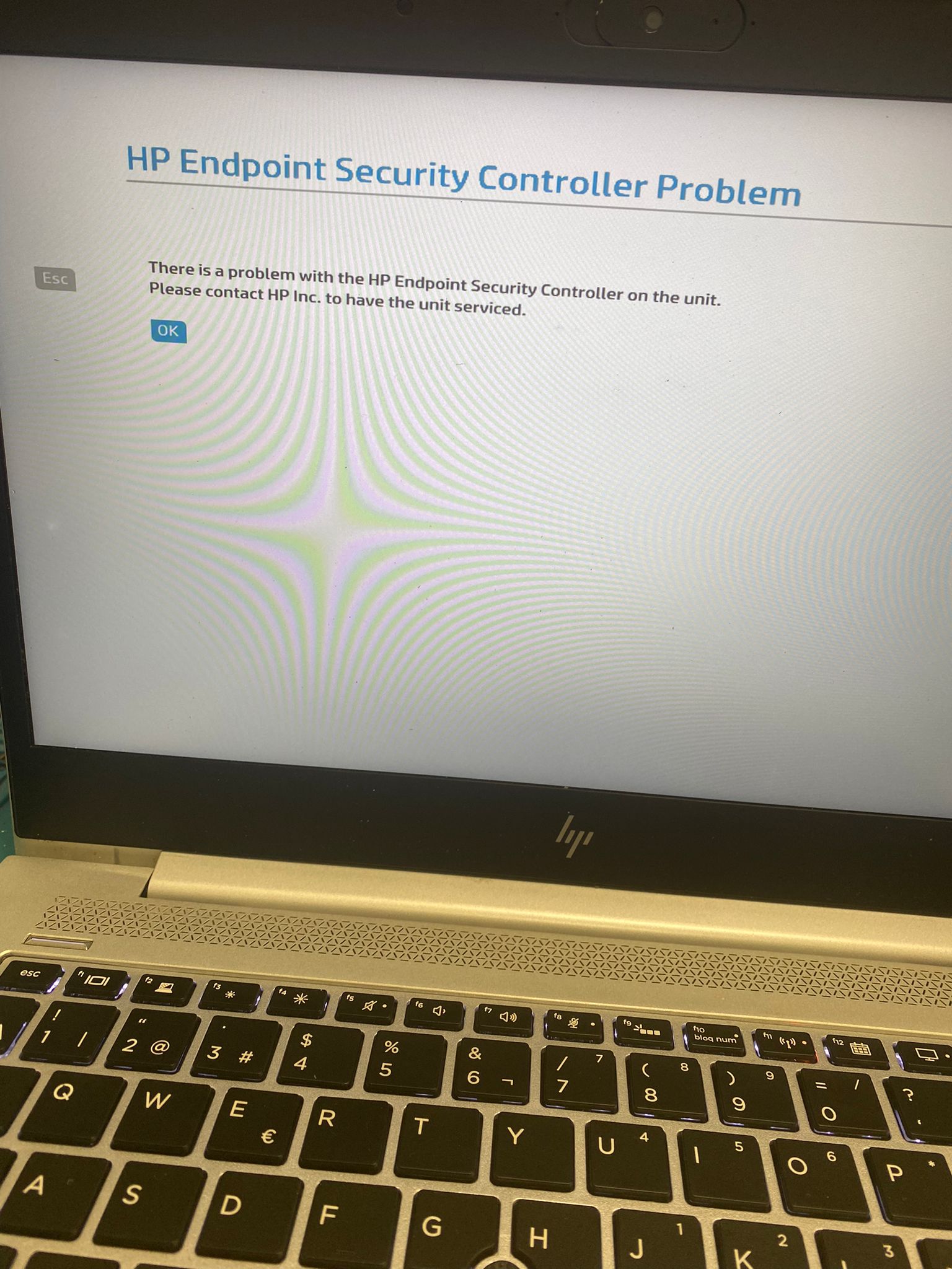

now laptop error what ?
