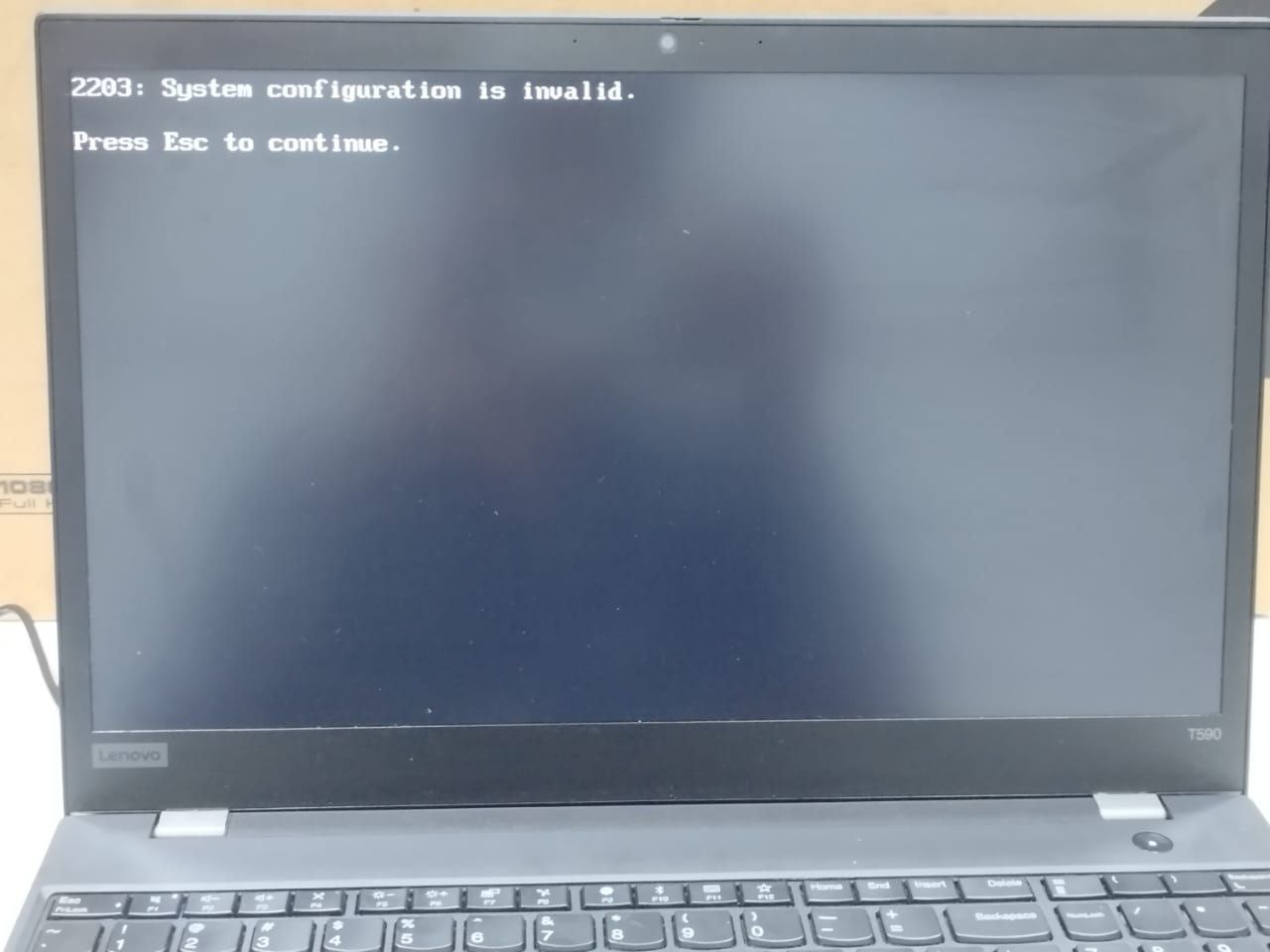

sending old bios plz rework and give . in this bios display is there but error coming.
![photo_2023-11-24_19-26-19.jpg](/data/attachments/375/375327-b6d70f6a27a4369a186ad86262b1e844.jpg)

This is not a problem from the bios file, the error is missing DMI because the EC has been replaced or programmedsending old bios plz rework and give . in this bios display is there but error coming.
