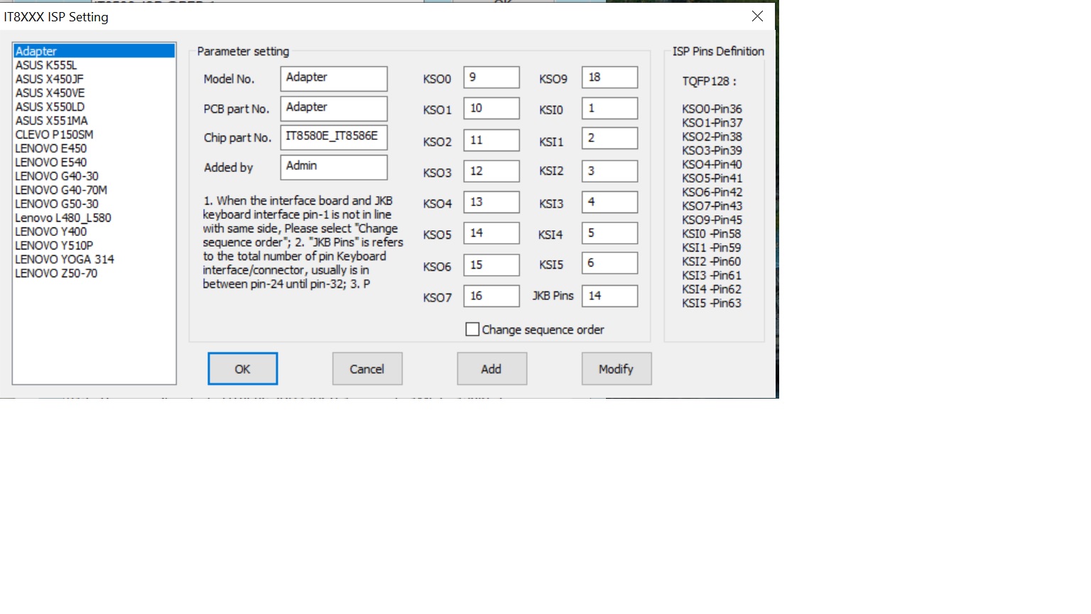

Hi, ThienBui , do you know if i am able to program the it8252e248a with rt809f with peb-1 adapter, how shoud i configure the pinout , because i dont see any pd0 ..... pd7 or busyKB_pins=36 LEFT DOWN 08MM PD0=29 PD1=20 PD2=15 PD3=23 PD4=14 PD5=16 PD6=12 PD7=30 BUSY=26 STB=18 AFD=28 INIT=21 SLIN=19 KSI4=22 KSI5=24 FLASH=248 CHIP=IT8252E-
Difficult I think impossibleHi, ThienBui , do you know if i am able to program the it8252e248a with rt809f with peb-1 adapter, how shoud i configure the pinout , because i dont see any pd0 ..... pd7 or busy
Is it posible With rt809h or only svod4 ?Difficult I think impossible
