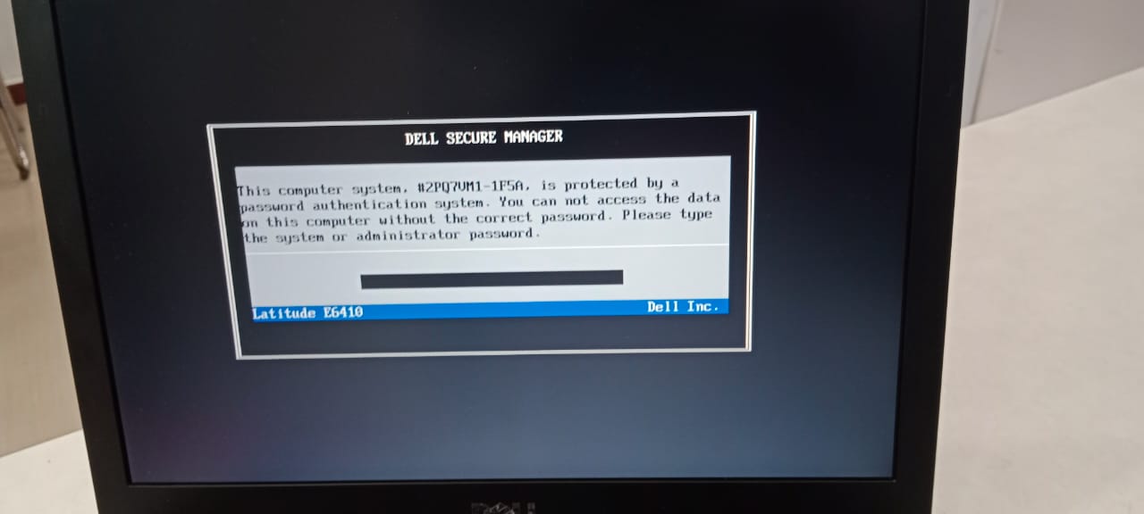

Dell e6410 bios password
DELL E6410 PLZ UNLOCK
Please read the instructions CAREFULLY.
INSTRUCTIONS:
- Type the 16-character password. For UPPERCASE characters use SHIFT key. Take your time while typing password, my suggestion is to use NATO Phonetic guide under password (a-alpha, B-BRAVO, C-CHARLIE...).
- Once you are done typing password, hold down left CTRL key and press ENTER key twice (CTRL-ENTER-ENTER).
(Password is to be typed using a standard US QWERTY keyboard).
NOTE: Sometimes if using master password within Setup/BIOS, just pressing ENTER after typing password will do.
2PQ7VM1-1F5A
Password:SMSQlFt3mQzD8F2M
S - SIERRA ( UPPERCASE )
M - MIKE ( UPPERCASE )
Q - QUEBEC ( UPPERCASE )
l - lima ( lowercase )
F - FOXTROT ( UPPERCASE )
t - tango ( lowercase )
3 - 3 ( digit )
m - mike ( lowercase )
z - zulu ( lowercase )
D - DELTA ( UPPERCASE )
8 - 8 ( digit )
2 - 2 ( digit )
