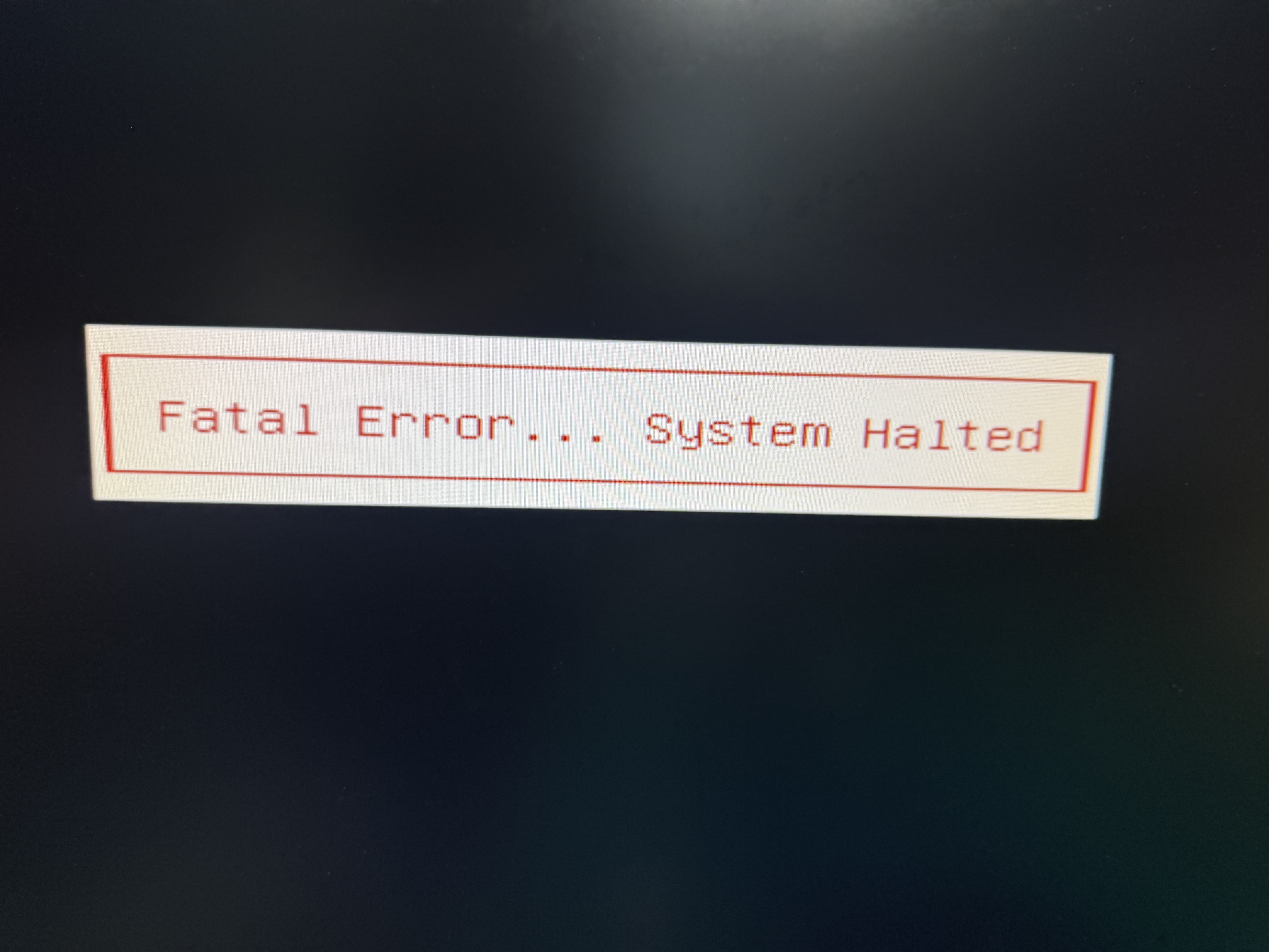

I have D30 mainboard Descartes Rev 1.1.. that cycles codes hangs at code 62 with original bios no picture... if i flash any of the 2 above files i get boot picture lenovo splash screen with f04 code and nothing happens (post codes dont change in the process). Can anyone help ? Do i need to flash something else ? attached original bios with code 62 no picture... Also recovery mode with usb does not work with orginal bios... with the 2 files posted above it hangs at starting recovery with lenovo screen.
need to try a new bios to compare
I have tried all bioses for d30 posted above... i get picture with "LENOVO" but hangs there... Could you maybe help me find a correct image ? I have d30 type 4223 model 3V3. Cannot find anything specificaly for this exact model.
so it might not be a bios problem
