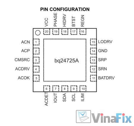

ThienBui Techniques Supporter May 16, 2014 #1 BQ25A bq24725A Download list BQ25A.pdf 1.7 MB · Views: 584 Upvote 0 Downvote
ads Active Member SUPER VIP Dec 11, 2019 #2 ThienBui said: BQ25A bq24725A View attachment 5352 Click to expand... can it replace by BQ24725 ?? i see the pinout is same https://2.bp.blogspot.com/-20SS05Ki...yLr36ZRexhY-CpeI30uACLcBGAs/s1600/bq24725.png
ThienBui Techniques Supporter Dec 11, 2019 #3 ads said: can it replace by BQ24725 ?? i see the pinout is same https://2.bp.blogspot.com/-20SS05Ki...yLr36ZRexhY-CpeI30uACLcBGAs/s1600/bq24725.png Click to expand... yes, same
