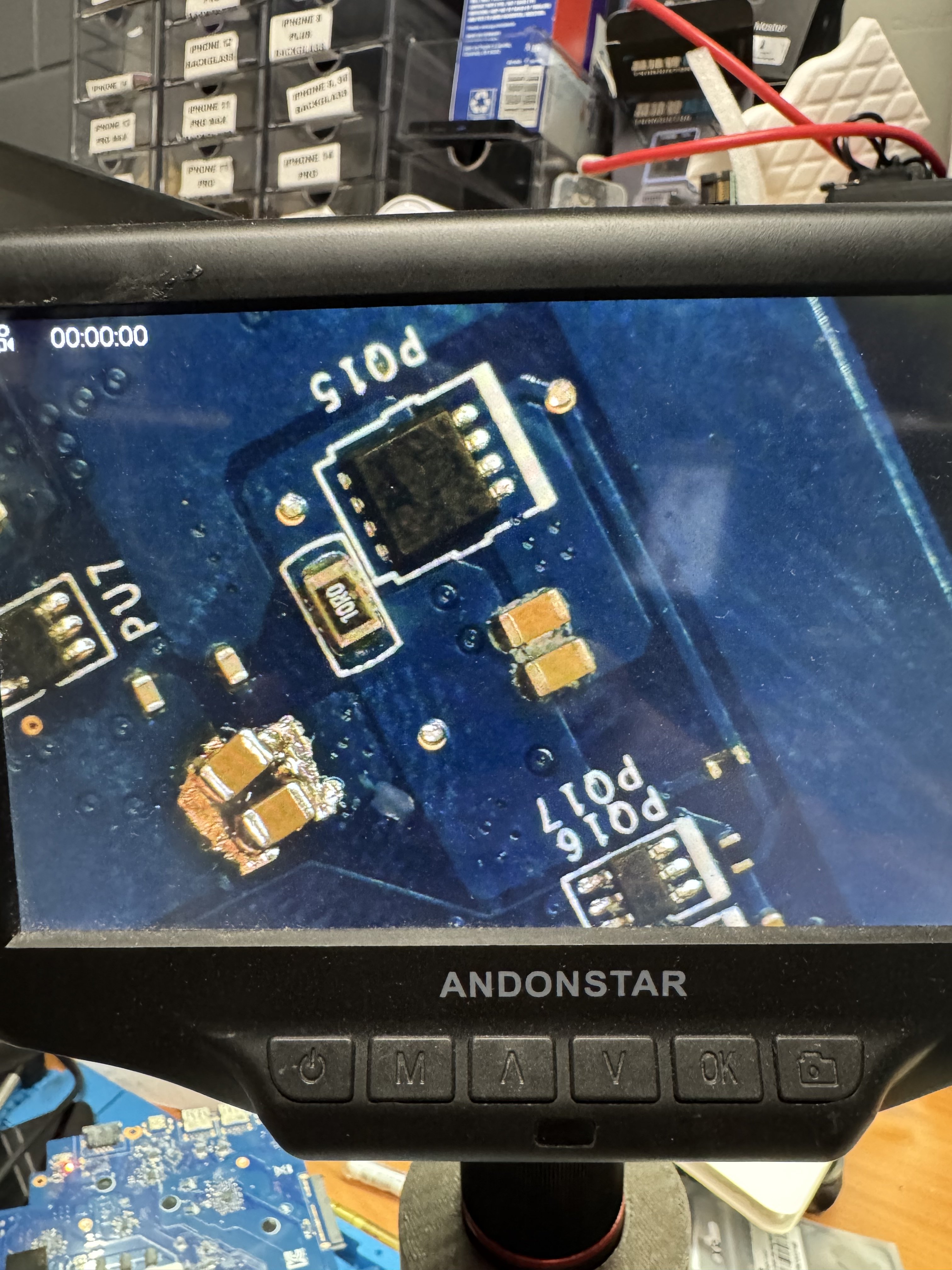

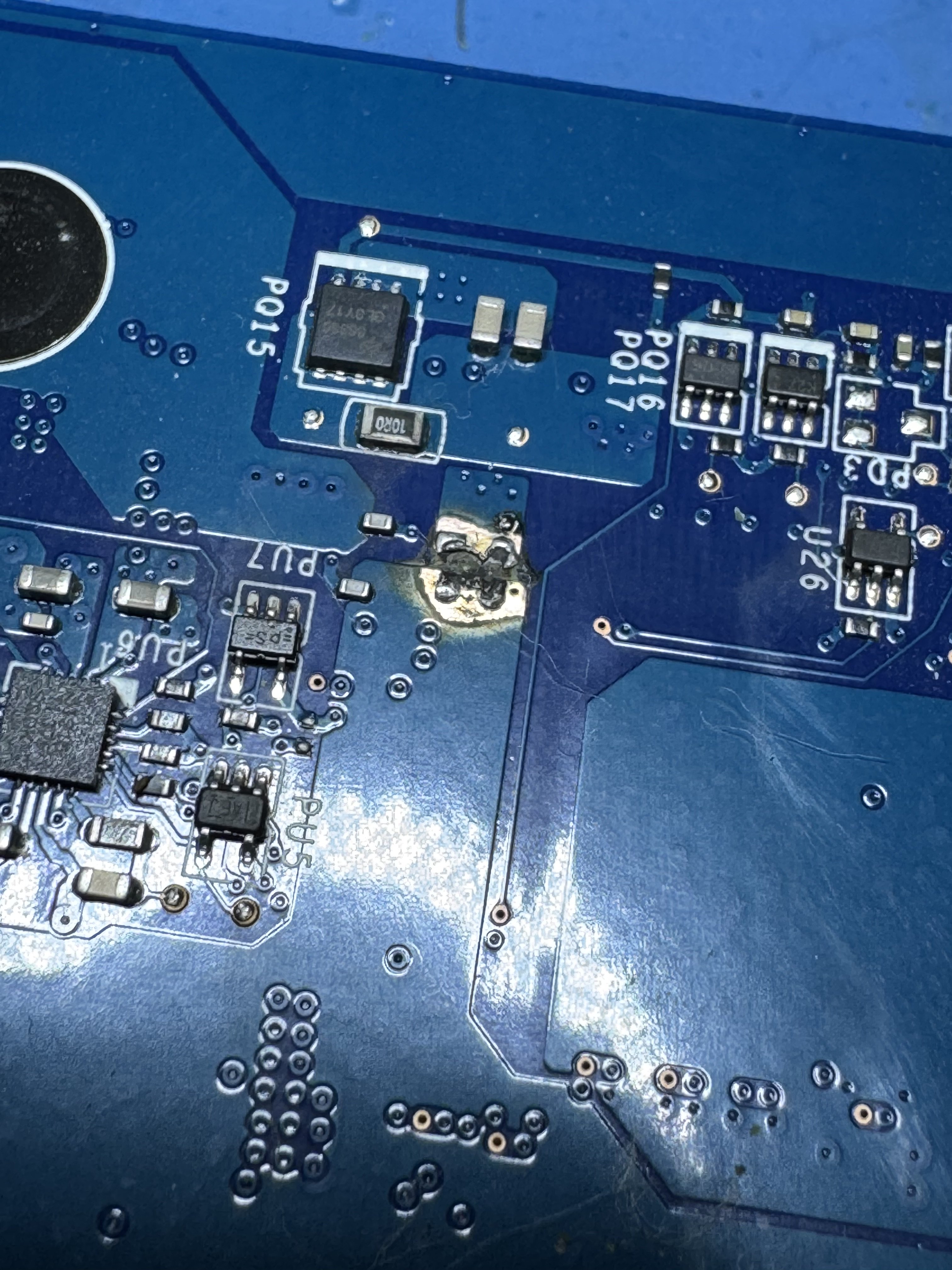

Hi! Im looking to see if anyone has the schematic for the MS-16R81 Ver 2.0 board i have a backlight issue and two of the caps exploded i replaced those but am still getting no backlight trying to look upstream.
Replying because my girlfriend actually managed to find a boardview on some russian website, cost a few bucks but that combined with a bill of materials I found helped my fix it the blown components were some Ferrite bead inductors not capacitors (I just assumed because of the damage) but after replacing those the backlight is working again. Posting the Files here in case it helps someone else.
