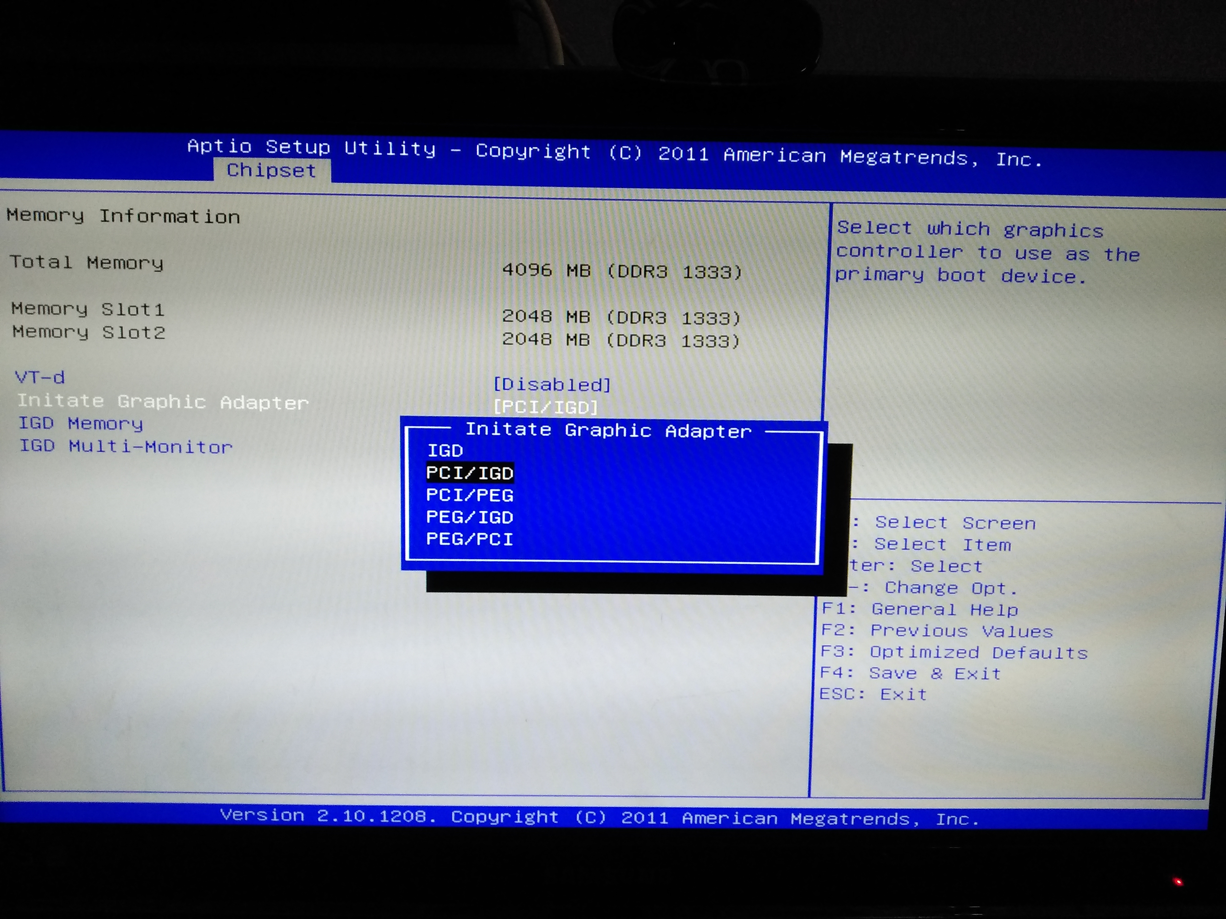

I bought a new GPU, but as soon as I install it, the system stack at the logo screen, can't get into bios and then restarts. Trying to find all solutions to the problem through the internet
did you attach an extra VGA card?
Finally found it!!!!
Got into the BIOS using integrated graphics, under Chipset/North Bridge tab there is an option for Initiate Graphic Adapter as it is shown in the picture. The trick was to switch it to PCI/IGD. This BIOS version seems to recognise my new GTX 1650 Super as PCI, not as PEG (PCIe) for some reason. Just installed the new drivers and everything is running smoothly!!! Thnx anyway!
