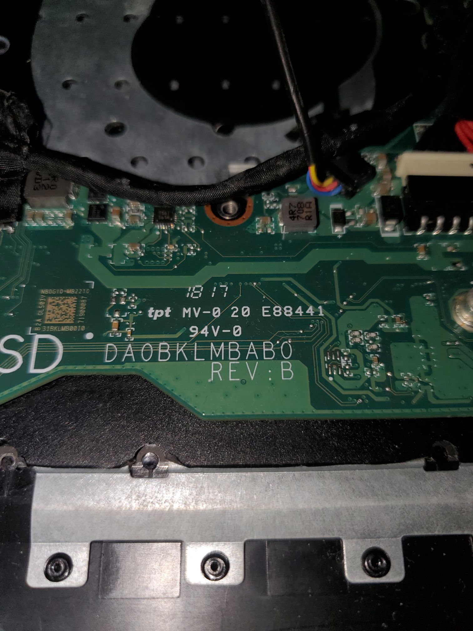

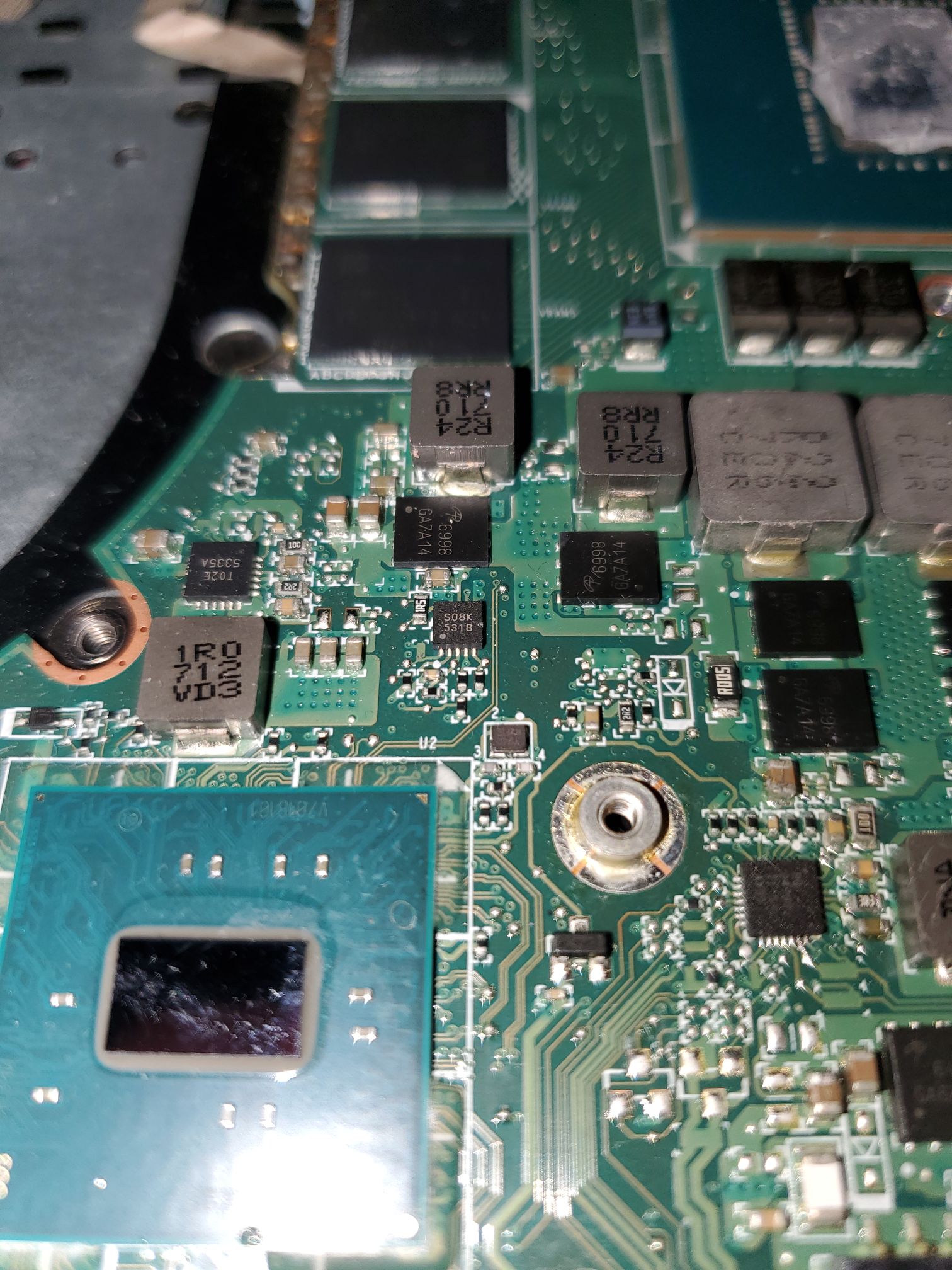

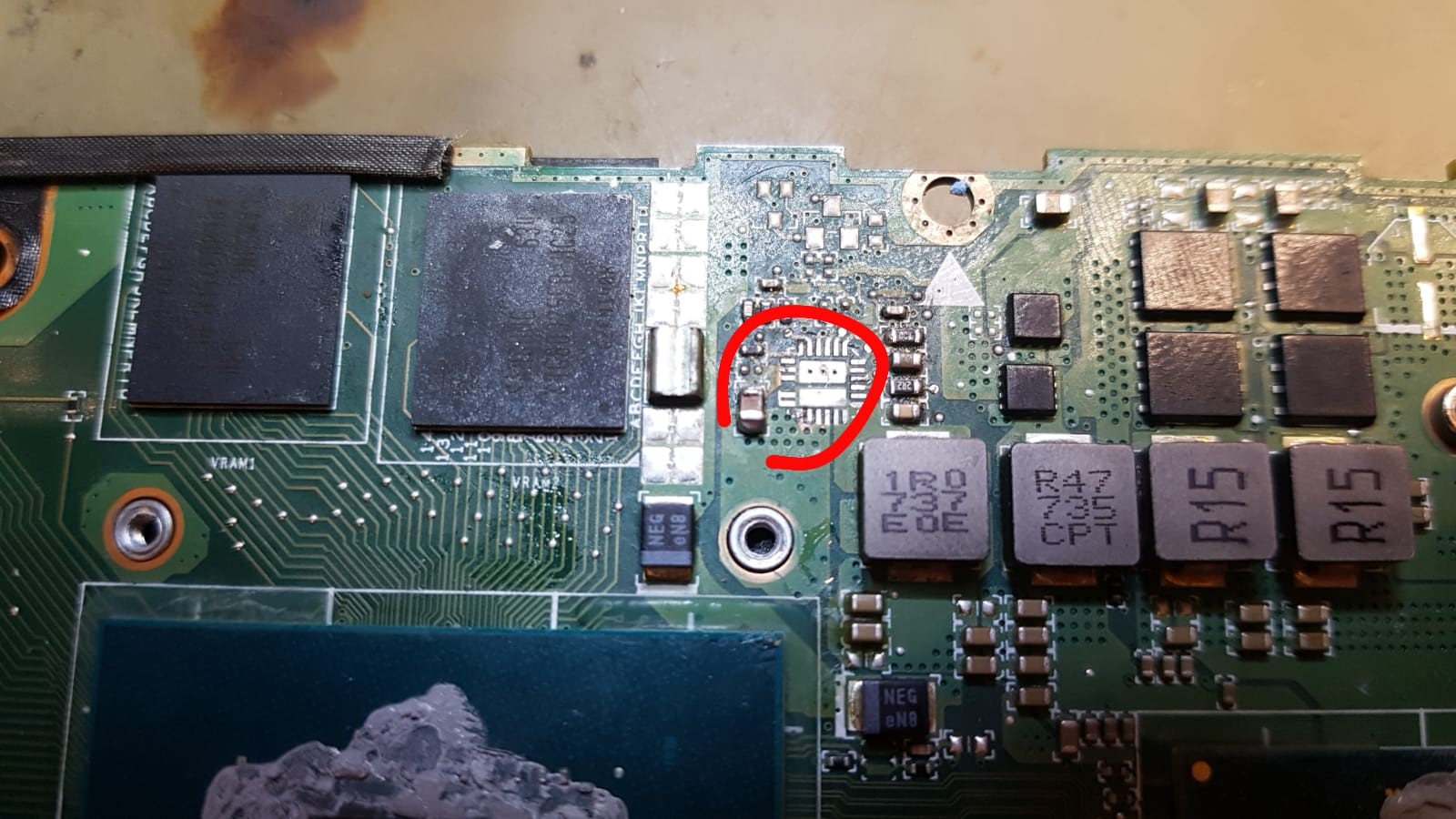

anyone have good quality board photos? a technician took an IC without put it back.
or someone knows what this IC is?

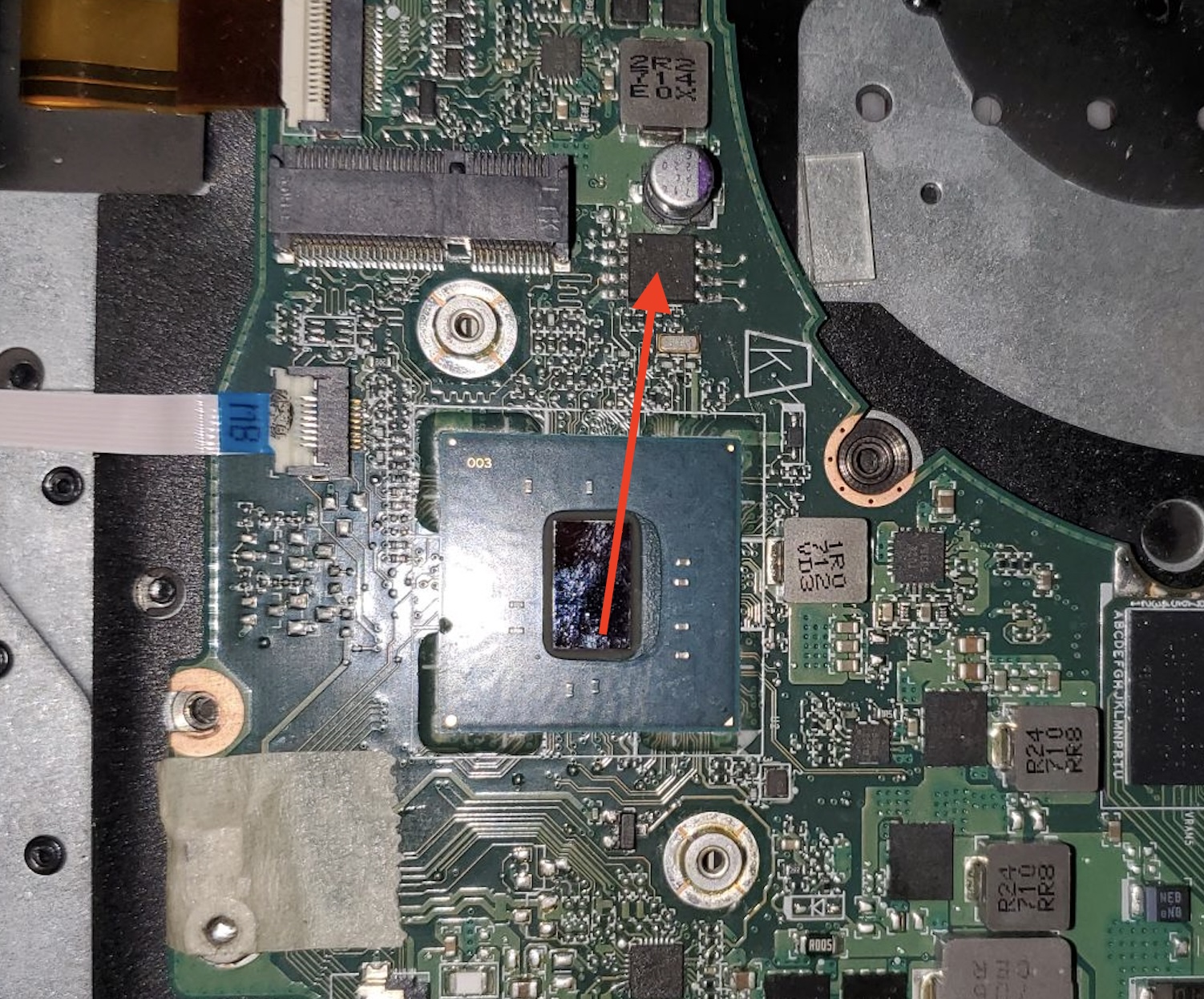

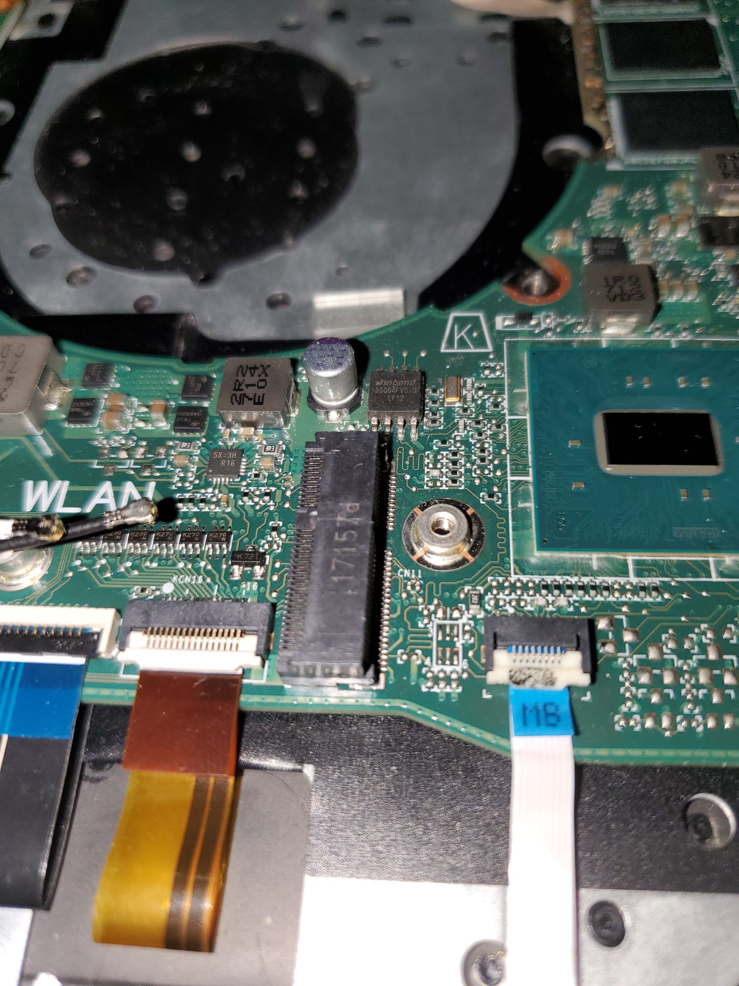

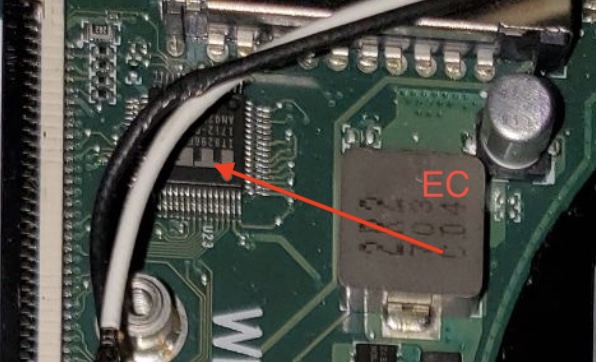

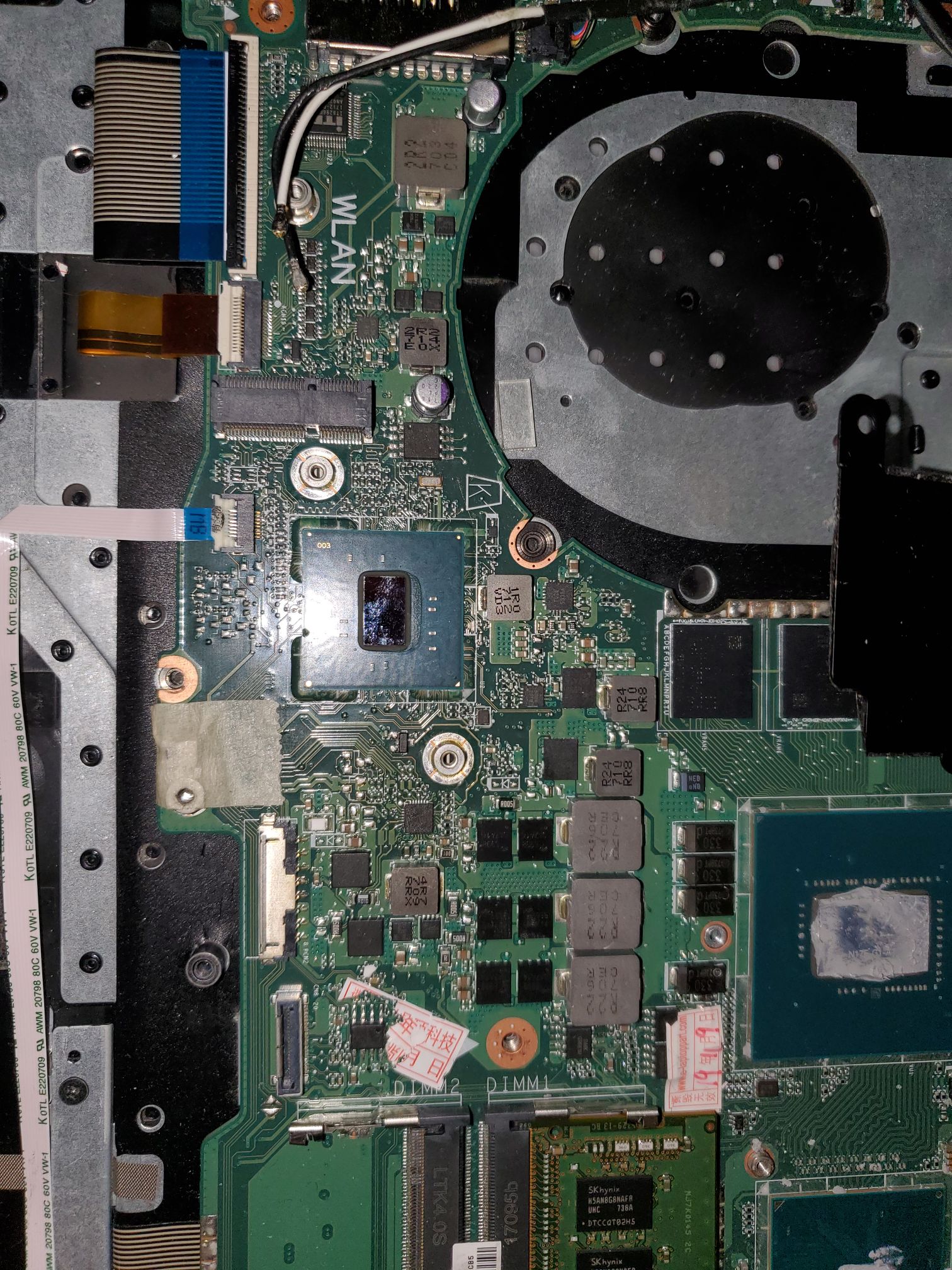

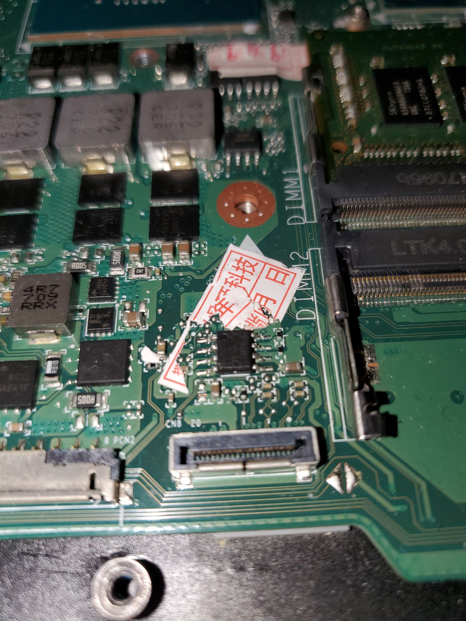

Hello,
Do you know where is located BIOS and where is located EC?
Thank you. I bricked my motherboard and i need to flash but i don't know which to flash.
20220217_180225.jpg 20220217_180257.jpg 20220217_180310.jpg 20220217_180401.jpg 20220217_180434.jpg
only care 1 BIOS main 8MB
Thank you so much, this is what i thought.
I flashed it 2 times with 2 different bioses and it still did not unbrick it but gave me two different results (311: no fan spin, leds, 315: fan spins, leds)
I bought the motherboard from china and before updating bios it had a bios i had never seen on this laptop. Do you think they used a custom one? Thank you.
