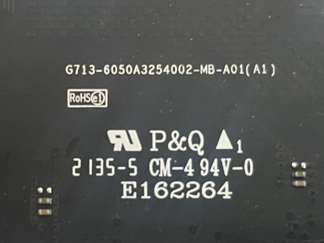

AMD CPU no have clearmeG713-6050A3254002-MB-A01(A1)
after logo nothing showing
Please clear ME
how about new bios or rebuildAMD CPU no have clearme
AMD no have buiidslhow about new bios or rebuild
I can't find this model bios anywhereAMD no have buiidsl
you can use any bios another replace
Hellow, I have no video.I can't find this model bios anywhere
1mb no have checkHellow, I have no video.
The bios chip ic is 25q80dvsig and the dump size is 1mg.
Is it posible?
I want to flash a new bios, what can I do?
1mb no have check
Sorry, what do you think I can do?1mb no have check
main bios is 16mbSorry, what do you think I can do?
Replace the ic?
Main bios is in a diferent IC?main bios is 16mb
why need Programming 1mb ?
yesMain bios is in a diferent IC?
