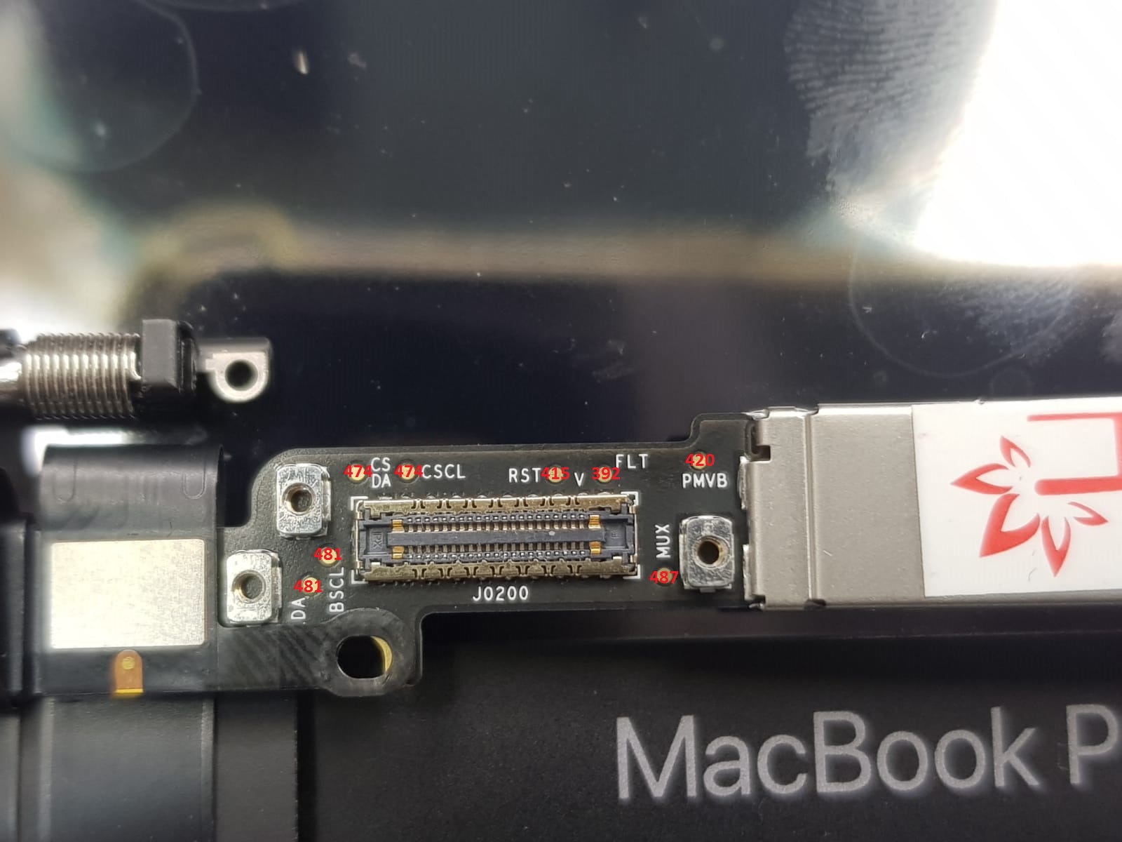

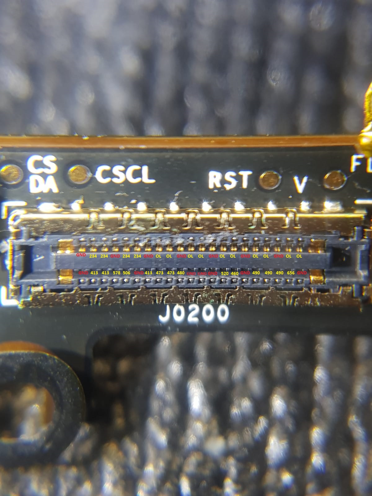

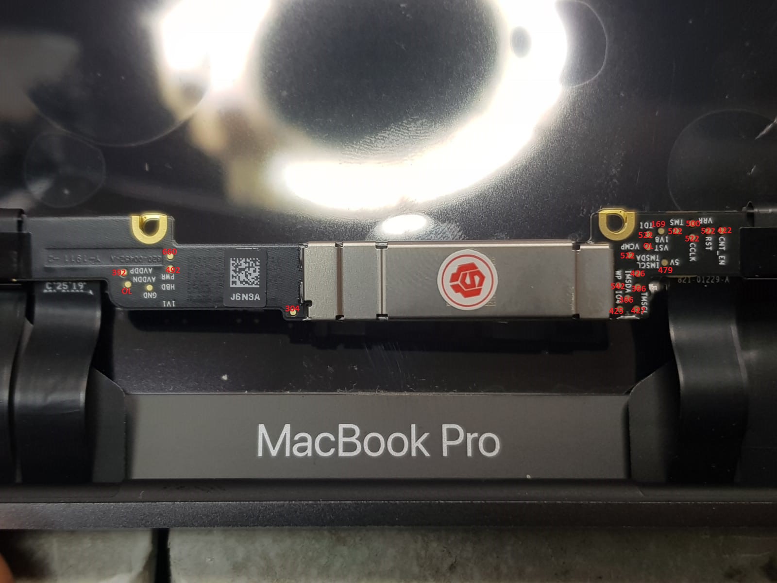

Macbook A1708 display problem. The system is working well after switching on the power button. There is an issue with the Display. The display has getting disappeared when the display lid open at 90 degree angel. But its working fine at 30-35 degree angle. Please help me to fix this issue.
